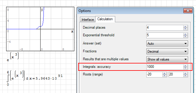

SMath Forum SMath Studio Bugs & Problems Integration Error 1 Pages (2 items) Integration Error - integration of e(x^3) is different from HP50G, TI 89 and PTC - Messages Go to last post #1 Posted: 11/25/2015 3:48:14 PM Nagy 0 likes in 1 posts. Group: User Integration of e(x^3) from 0 to 6 gives the following1- sMath 7.4662*10^912- HP50G 5.964*10^913- TI 89 5.9639*10^914- PTC 5.964*10^91What's wrong? #2 Posted: 11/25/2015 7:18:55 PM Davide Carpi 1,442 likes in 2,934 posts. Group: Moderator You have to increment the accuracy of the integration.This option is available in: Tools > Options > Calculation If you like my plugins please consider to support the program buying a license; for personal contributions to me: paypal.me/dcprojects 1 Pages (2 items) New Posts No New Posts
