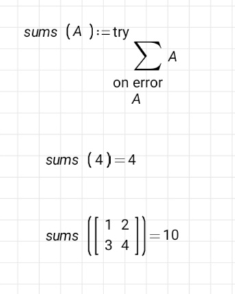

#2 Posted: 4/18/2022 9:50:44 AM
1,440 likes in 2,929 posts.
#3 Posted: 4/18/2022 9:51:14 AM

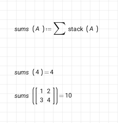

#5 Posted: 4/18/2022 10:22:36 AM
You're welcome
Note that using the stack approach you don't need the zero
