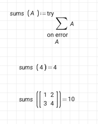

I have tried this function in order to be able to add together all the elements of a list (or vector) of variable length, including having one single element, but I don't know how to make it work.
suml(a):=if IsDefined(length(a))
sum(a)
else
a
It says "syntax is incorrect"...
Any suggestion?
If the boolean testing is "false" then is the "true" option evaluated or not? (I guess it shouldn't...)
Thanks in advance
Laurent

Hello I found a solution:
suml(a):=line(
a:=stack(a,0)
sum(a)
Sorry to have bothered this forum with such a basic question !

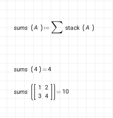

You're welcome
Note that using the stack approach you don't need the zero
#6 Опубликовано: 18.04.2022 11:07:54

You're welcome
Ha! :d :d That's puzzling! You can "stack" nothing on something!
Anyway, around this remarquable Smath Studio software is a no less remarquable community!
