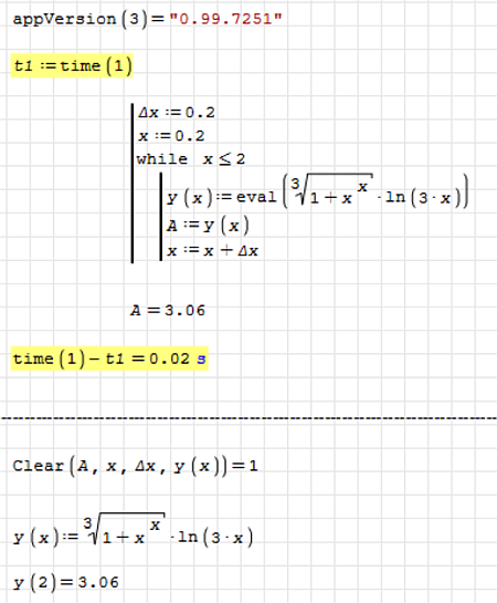

Hi everyone, I've got problem with while loop. I have this function with Xstart = 0.2 ; Xfinish = 2 ; deltaX = 0.2 and I need to solve it in smath studio, but while loop is processing forever and never ends. I'm doing something wrong, or it's a bug? Thanks!
Images:
https://postimg.cc/Q9mqWkKd Smath studio
https://postimg.cc/KKZkgXPt Function I need to solve

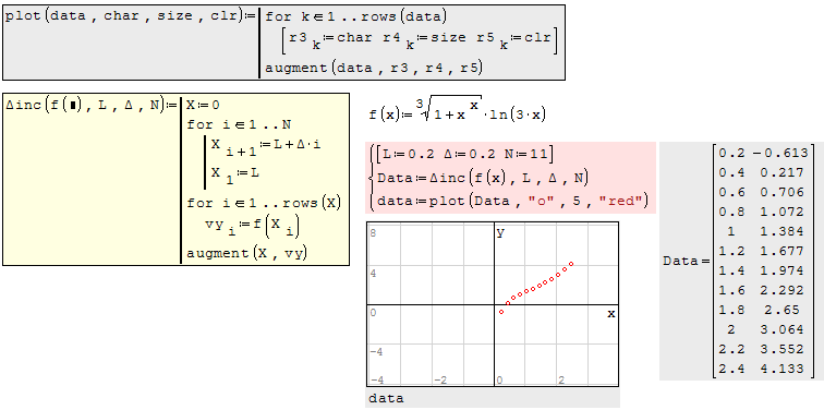

Is this what you need?

No, I need a range of numbers for X and Y, like: First X = 0.2, it's calculating Y(0.2) and shows first Y result, then X = 0.4 (previous X + delta X) and it's calculating Y(0.4), and until x = 2. In final I need a range of all X and all Y results.

I'm not sure I understood how to solve my function by this examples.
I don't know what I'm doing wrong:

You can do the job using a while loop but it is just one option (perhaps not the most straightforward one).
loops.sm (10 KiB) downloaded 1233 time(s).

I need all X and all Y(x) values in the end, for Xfirst = 0.2, Xlast = 2 with step 0.2.
y(0.2)=
y(0.4)=
y(0.6)=
y(2)=
And it should look something like this:
x= 0.2 y= -0.6126
x= 0.4 y= 0.2173
x= 0.6 y= 0.7064
x= 0.8 y= 1.0721
x= 1.0 y= 1.3842
x= 1.2 y= 1.6771
x= 1.4 y= 1.9738
x= 1.6 y= 2.2924
x= 1.8 y= 2.6501
x= 2.0 y= 3.0639
I can type every y(x) in smath studio:
https://postimg.cc/0bddLTqF
But, is it possible to do it with while loop?
