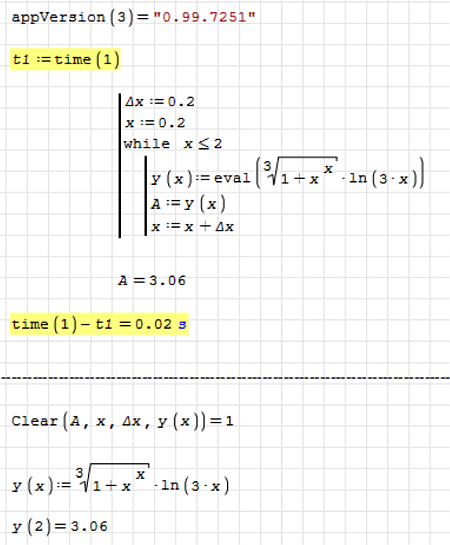

Hi everyone, I've got problem with while loop. I have this function with Xstart = 0.2 ; Xfinish = 2 ; deltaX = 0.2 and I need to solve it in smath studio, but while loop is processing forever and never ends. I'm doing something wrong, or it's a bug? Thanks!

#4 Posted: 3/13/2020 5:30:47 PM
WroteI'm doing something wrong, or it's a bug? Thanks!
Some examples ...

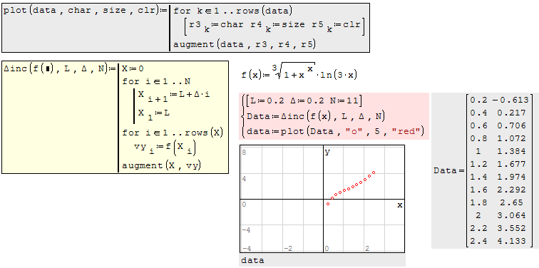

#6 Posted: 3/13/2020 8:38:39 PM
WroteI'm not sure I understood how to solve my function by this examples.
Your proposal is not a case of while loop,
strictly wrong application.
Page44 Unknown.sm (73.22 KiB) downloaded 1413 time(s).

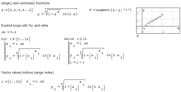

#7 Posted: 3/14/2020 6:06:47 AM
You can do the job using a while loop but it is just one option (perhaps not the most straightforward one).
loops.sm (10 KiB) downloaded 1233 time(s).

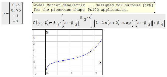

#12 Posted: 3/14/2020 10:11:42 AM
Pascal is pretty retarded these days for Engineering applications !
Years ago, Mathcad for Universities was pretty freaked.
Better use Smath productive for studies & Engineering.
Golden ratio will be a life time productive Companion.
As well as an advanced WhileLoop.
Golden Ratio jmG.sm (39.41 KiB) downloaded 1193 time(s).
