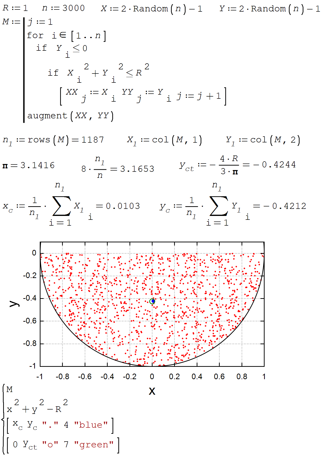

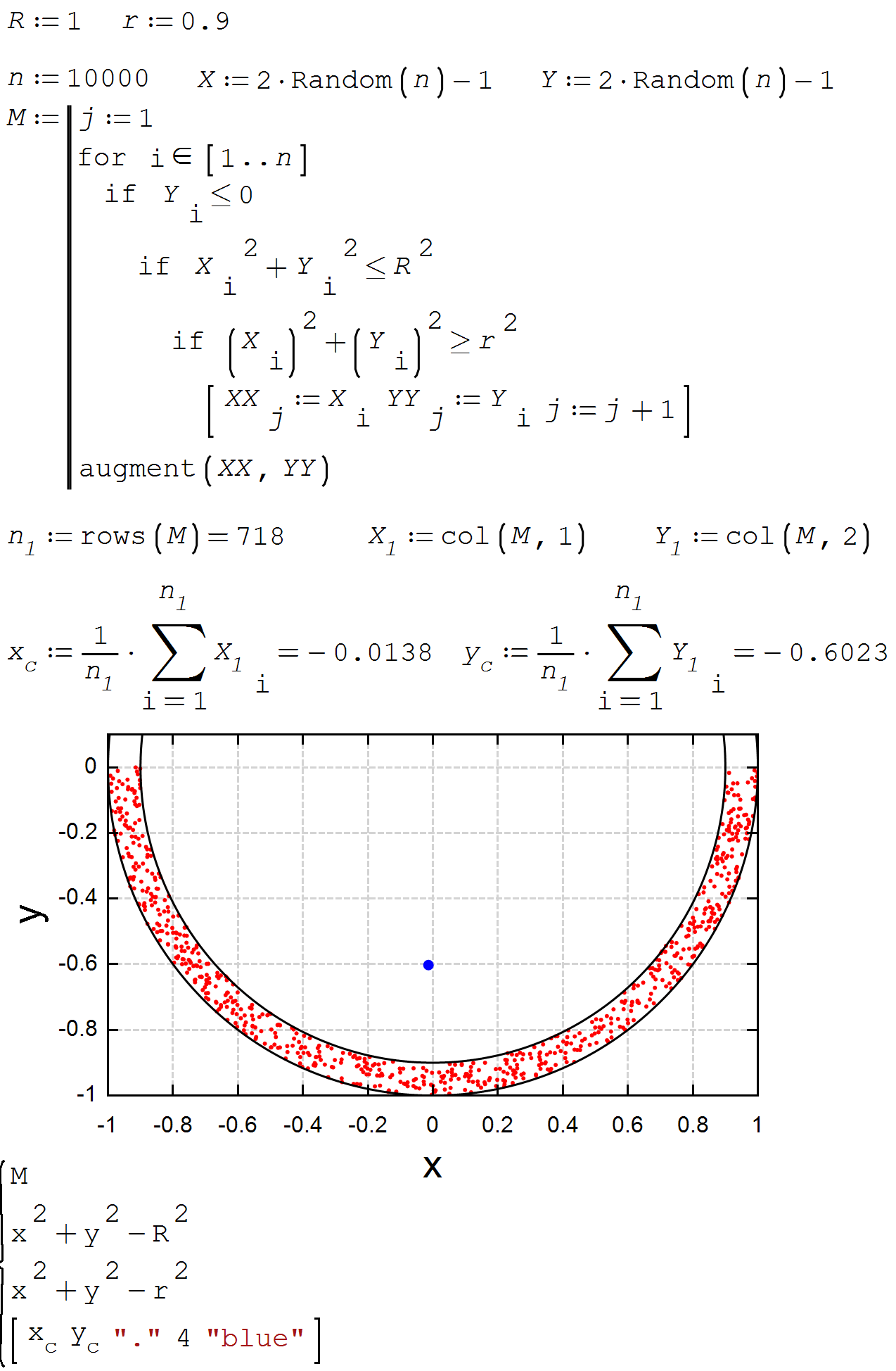

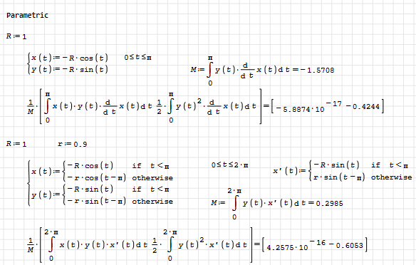

Help me please - see attach
Gravity-Center-n-points.sm (331.61 KiB) downloaded 1545 time(s).
#2 Posted: 5/11/2024 3:04:22 PM
Valery Ochkov
Valery Ochkov
67 likes in 713 posts.
Solutions for same mass of points. OK?
Gravity-Center.sm (14 KiB) downloaded 1606 time(s).

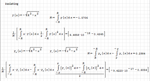

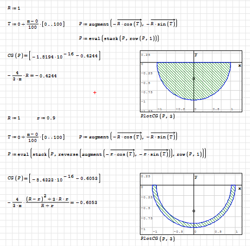

For comparison, the true value for your semi-annulus is given by 4*Reff/(3pi),
where Reff = ( (R-r)^2 + 3R*r )/(R+r).
With R=1 and r = 0.9 this is 0.60534722.

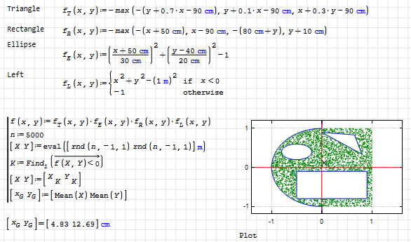

#4 Posted: 5/12/2024 8:17:01 AM
1,139 likes in 1,805 posts.
Hi. Using Martin's Momentums functions for polygons.
mass-center.sm (38.17 KiB) downloaded 1787 time(s).
or (adenda)
mass-center more.sm (21.61 KiB) downloaded 1675 time(s).
sergio 5/12/2024 11:55:00 PM, Valery Ochkov 5/13/2024 1:50:00 AM

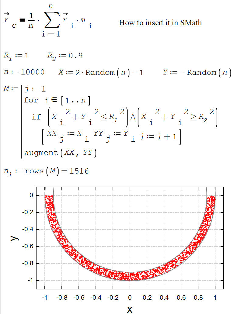

Oh, I see. The intention is to use statistical functions. This vectorized version can replicate more or less the results, but SMath is very slow for large vectors.
mass-center-statics.sm (52.11 KiB) downloaded 1581 time(s).
mass-center-statics.pdf (307.24 KiB) downloaded 906 time(s).
