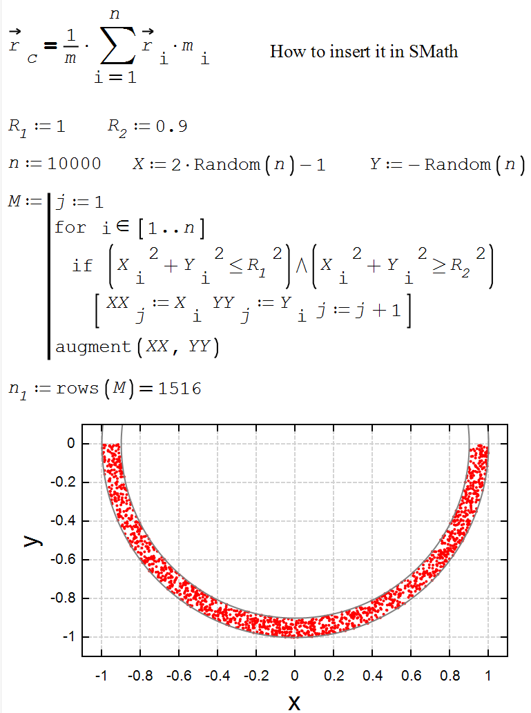

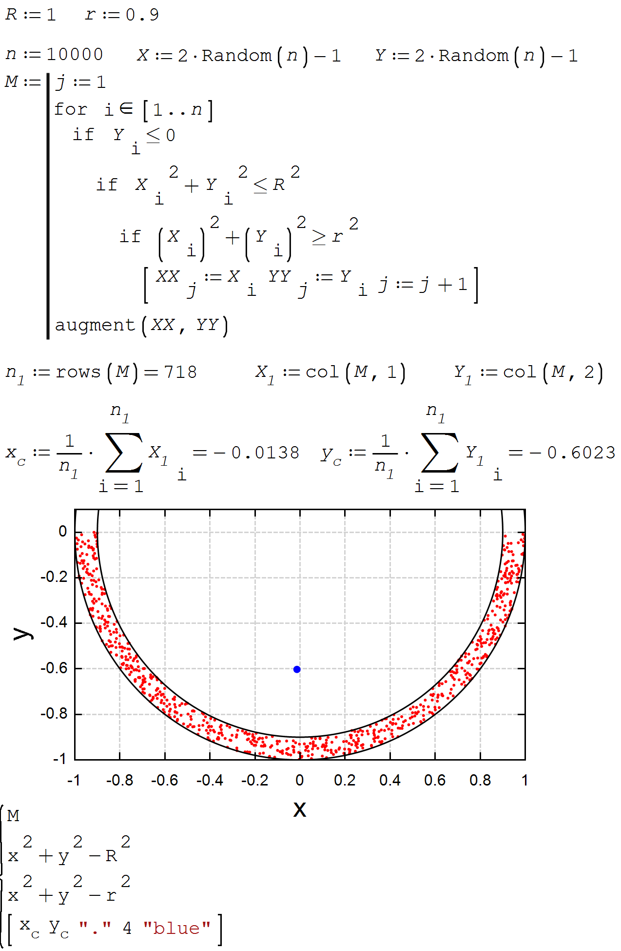

Help me please - see attach
Gravity-Center-n-points.sm (331,61 КиБ) скачан 1505 раз(а).

Solutions for same mass of points. OK?
Gravity-Center.sm (14 КиБ) скачан 1572 раз(а).
One test

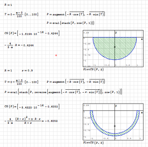

For comparison, the true value for your semi-annulus is given by 4*Reff/(3pi),
where Reff = ( (R-r)^2 + 3R*r )/(R+r).
With R=1 and r = 0.9 this is 0.60534722.

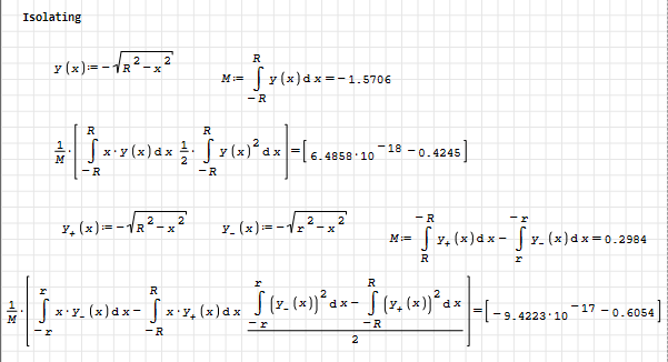

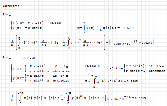

Hi. Using Martin's Momentums functions for polygons.
mass-center.sm (38,17 КиБ) скачан 1749 раз(а).
or (adenda)
mass-center more.sm (21,61 КиБ) скачан 1642 раз(а).

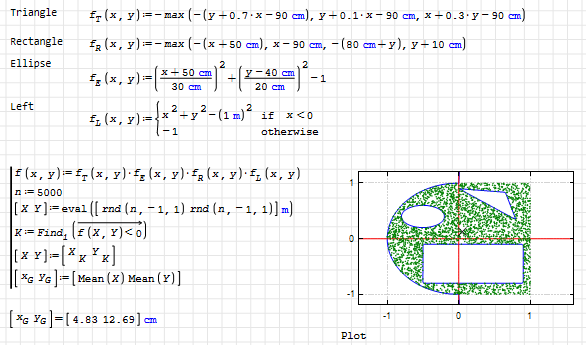

See please pictures in my old article
Physics and computer science: the center of gravity of a black box
http://twt.mpei.ac.ru/ochkov/Center-Gravity.pdf

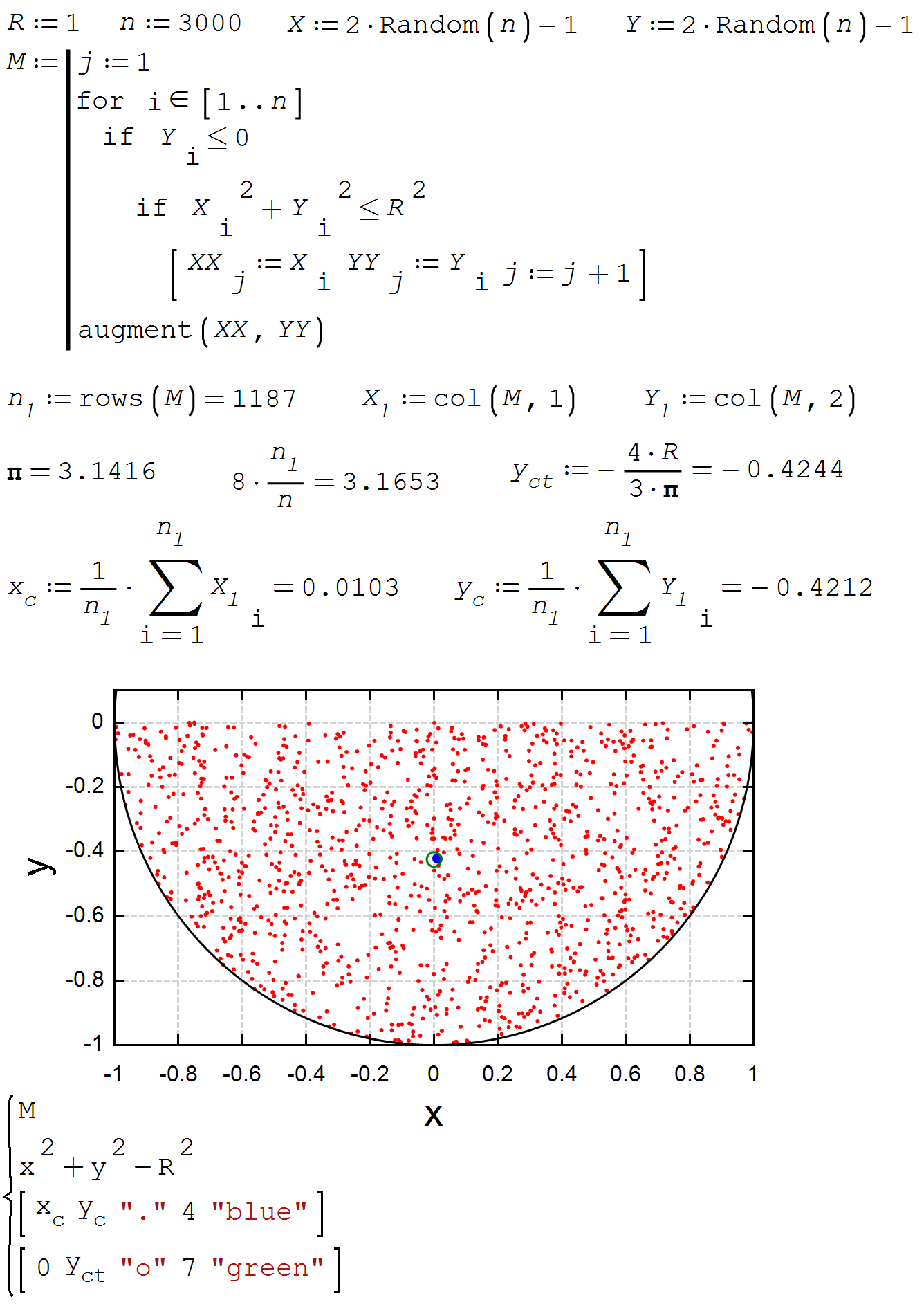

Oh, I see. The intention is to use statistical functions. This vectorized version can replicate more or less the results, but SMath is very slow for large vectors.
mass-center-statics.sm (52,11 КиБ) скачан 1542 раз(а).
mass-center-statics.pdf (307,24 КиБ) скачан 871 раз(а).
