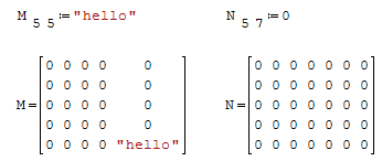

#7 Posted: 2/3/2017 6:51:10 PM
WroteBut it is not.
A matrix of order zero is a "zero matrix"
If you want it rectangular from the fx menu
'Ones(3,5)' ,,,, then of any value: *1.23456789=

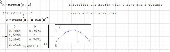

#8 Posted: 2/3/2017 9:29:55 PM
Arie 2/3/2017 10:03:00 PM
#9 Posted: 2/3/2017 10:03:19 PM
Awesome. Thanks, Martin. I did not know that empty matrices were supported.

WroteI need to create matrix of order 0
At this point, you know how to create a "zeromatrix".
Visit "Samples => PseudoInverse" few days ago,
This type of matrix: you fill-in manually.
The other style matrices construct by themselves from their
governing algorithm. Download the attached work sheet.
