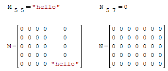

#2 Опубликовано: 03.02.2017 16:01:09
ZeroMatrix: like this

#7 Опубликовано: 03.02.2017 18:51:10
But it is not.
A matrix of order zero is a "zero matrix"
If you want it rectangular from the fx menu
'Ones(3,5)' ,,,, then of any value: *1.23456789=

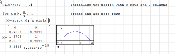

#8 Опубликовано: 03.02.2017 21:29:55
Example for declaration and use of an empty matrix:
stack.sm (11,99 КиБ) скачан 1517 раз(а).
Arie 03.02.2017 22:03:00
#9 Опубликовано: 03.02.2017 22:03:19
Arie
Arie
Awesome. Thanks, Martin. I did not know that empty matrices were supported.
