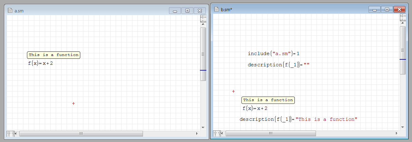

Is it possible for descriptions to be passed with include()?
See example
Mike Kaganski 4/14/2016 11:47:00 PM
#93 Posted: 4/15/2016 2:07:43 AM
1,558 likes in 1,868 posts.
No, now this is impossible. Function (AddDefinition() from SMath core lib ) which does the main job dosn't know about the description field for the definition. So I can't add this data.

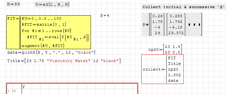

Using Jean's files in the same directory, I updated to Mike's sheet and compared it to UNI's pdf ... I still have an error in the re-definition of BETA. Using latest SMath and plugins. BETA.PNG

I have the equal sign. It's in Mikes updated sheet. The Beta in the screen shot I took shows 4; whereas Uni's PDF shows a 4x1 matrix (array)

Jean,
I have the equal sign.It's in Mikes updated sheet.The Beta in the screen shot I took shows 4; whereas Uni's PDF shows a 4x1 matrix (array)
You may have to put both work sheets in your Smath working directory.
If you read 4, instead of 1: it does not find the work sheet in question.
If it does not work: the problem is specific to your instalation.
