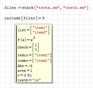

- restored the possibility of nested call of the include() function;
- added support for list of files.
It is now possible to implement the Reference component.

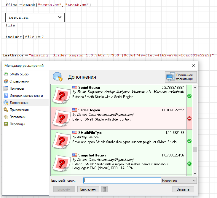

- added support for: numericupdown, pathpicker, mathcad block, script;
- lastError shows missing plugins for the last included file (function compares the dependencies of the include file with the current set of enabled plugins).

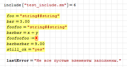

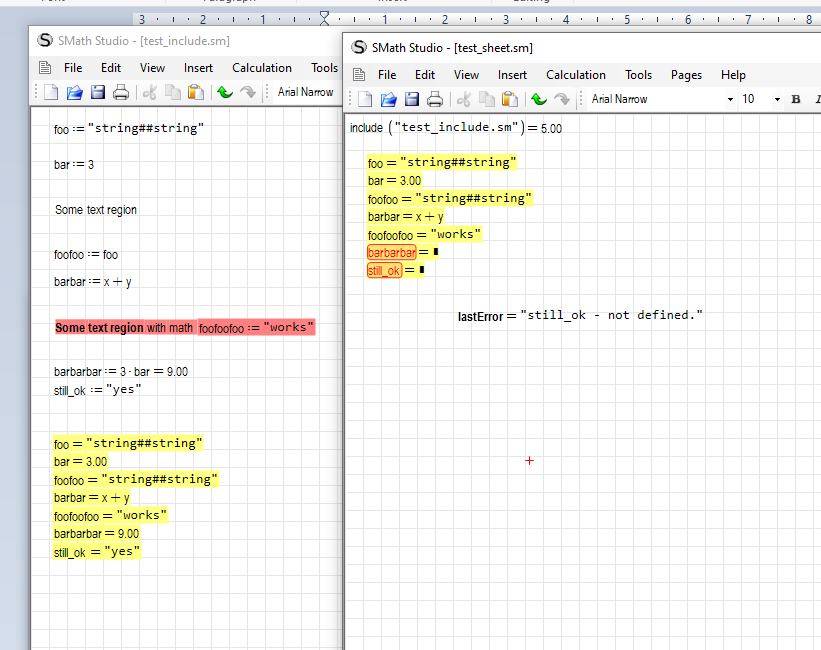

Thanks for the new updates. I found a bug. If I have a text region that has a formula, formulas after it will not be included.
test_sheet.sm (4.39 KiB) downloaded 1646 time(s).
test_include.sm (6.79 KiB) downloaded 1701 time(s).
SMath Studio compatibility
Plugin updated. For now I don't know how to parse math equations inside text region correctly.
Changes:
- text region partially supported.
