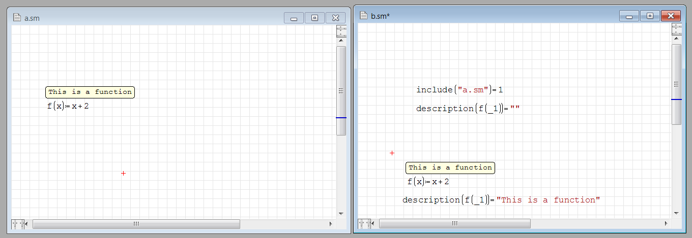

Is it possible for descriptions to be passed with include()?
See example
Mike Kaganski 14.04.2016 23:47:00
#93 Опубликовано: 15.04.2016 02:07:43
No, now this is impossible. Function (AddDefinition() from SMath core lib ) which does the main job dosn't know about the description field for the definition. So I can't add this data.

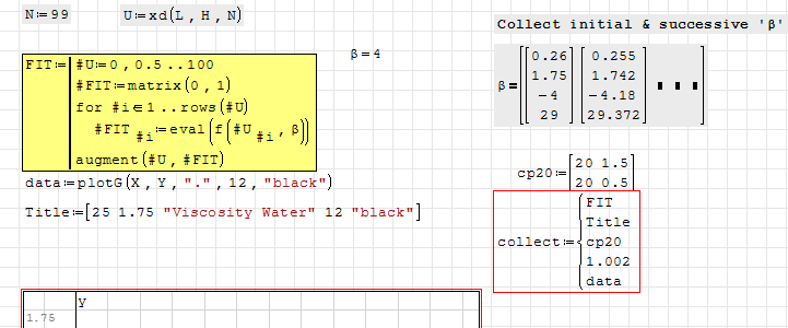

Using Jean's files in the same directory, I updated to Mike's sheet and compared it to UNI's pdf ... I still have an error in the re-definition of BETA. Using latest SMath and plugins. BETA.PNG

I have the equal sign. It's in Mikes updated sheet. The Beta in the screen shot I took shows 4; whereas Uni's PDF shows a 4x1 matrix (array)

I have the equal sign.It's in Mikes updated sheet.The Beta in the screen shot I took shows 4; whereas Uni's PDF shows a 4x1 matrix (array)
You may have to put both work sheets in your Smath working directory.
If you read 4, instead of 1: it does not find the work sheet in question.
If it does not work: the problem is specific to your instalation.
