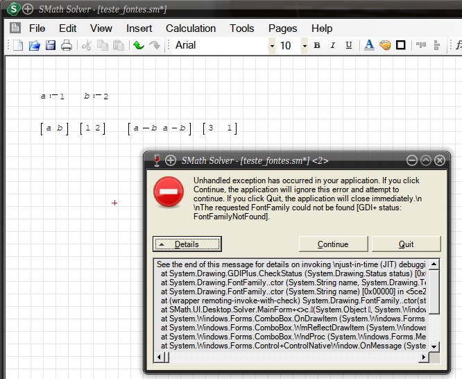

I don't know if someone has seen this before but I'm having problems with SMathStudio showing assign/evaluate (:=,=) and math operators (+,-) as shown below:
does anyone have an idea of what is going on?
I'm using OpenSuse, SMathStudio (Windows version with wine, but it also happens with the Mono version as well), latest stable/beta versions. It happens with new worksheets and with loaded worksheets.

Hi, I tried the courier font as well as other fonts and still it doesn't work.
Also, the program crashes if I try to change the font family:
I placed all font families in the folder mentioned before.

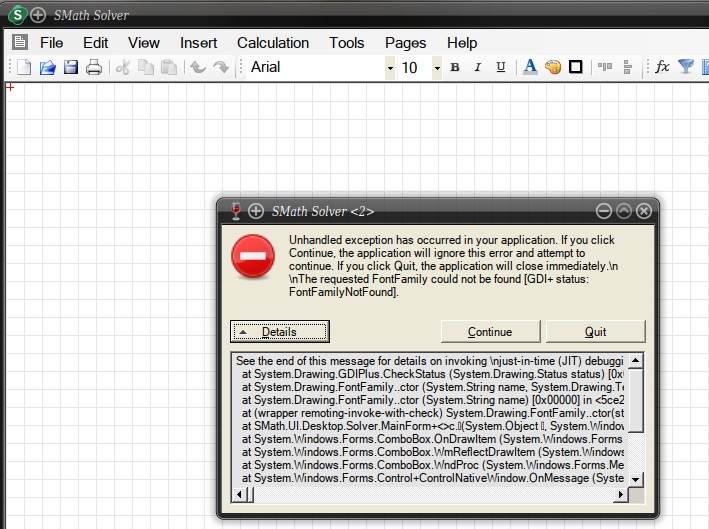

Same behavior, with mono:
#6 Posted: 7/3/2022 8:58:31 AM
601 likes in 1,382 posts.
I still see wine symbol at titlebar of error message.
Please make sure you have installed mono package installed.
And could you please check your inbox?
I will try to continue to help you from there.

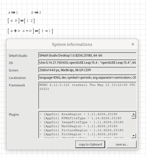

I have tried Smath with openSUSE_leap_15.4_live iso.
Seems everything is fine and working as it should be.
At first I tried with appimage I created. It is v0.99.7822 and it worked flawless.
Then I have installed mono-complete and downloaded latest v1.0.8206.
And there was no issue with it either, no problem with symbols or anything else.
Can't help you further from here without additional information.
