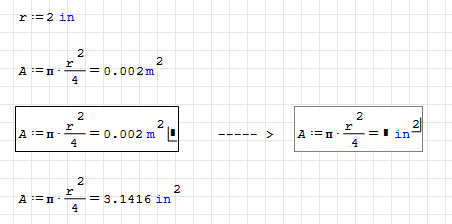

#4 Posted: 7/15/2020 4:59:34 PM
Calculating Area of a piston when I enter the diameter in inches the output is m2, how do I get the output units to in2?
... or like this in silent unit:
1. x*in ... in from unit panel
2. backspace twice to remove in
3. at this point you see a big round place holder,
4. in that special place holder ... in from unit panel
5. 'in in blue is now silent for result 'in²

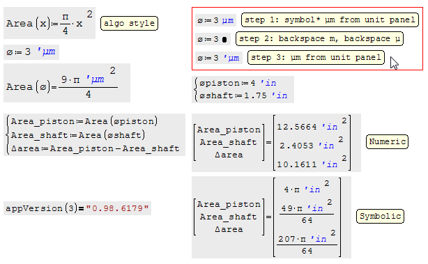

#5 Posted: 7/15/2020 6:29:56 PM
... make it hi-pro algo style.

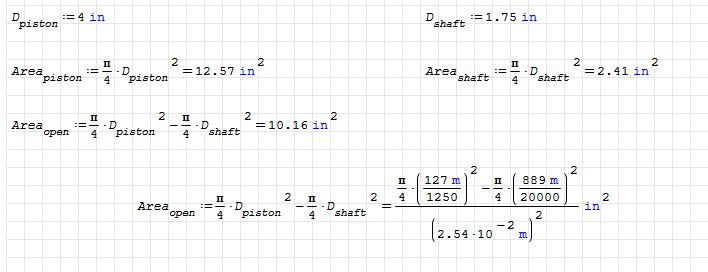

I want to thank everyone for their responses.
Cannot figure out the syntax of how to changes the units, I select so the box has the dogleg right then I type in^2 and get the result in not defined like I am adding another step to the calculation? Just typing in also gives me the same error.
#7 Posted: 7/15/2020 7:10:51 PM
... as explained above. Read again.
#8 Posted: 7/15/2020 7:30:48 PM
Make your project math style [no decoration, no gyzmas ...]
No syntax to freak, code accordingly.

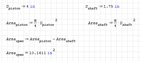

Once again, I want to thank everyone for their help.
I am going down the path of using the units. Took me a couple of attempts to get the in2 but it is now working
One follow-up, if I set the equation to optimization none to show the numeric values they all default to meters, is there a way to have them shown as inches?
#12 Posted: 7/16/2020 1:33:43 PM
Construct as is, it may have to do with your SS version.
Otherwise, you are wrongdoing, not following guidance.
