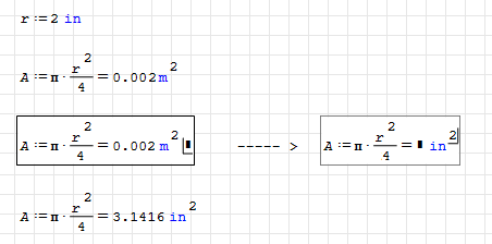

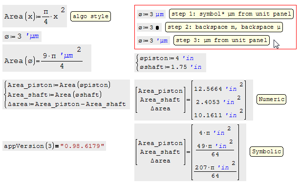

#5 Опубликовано: 15.07.2020 18:29:56
... make it hi-pro algo style.

#7 Опубликовано: 15.07.2020 19:10:51
Cannot figure out the syntax of how to changes the units
... as explained above. Read again.
#8 Опубликовано: 15.07.2020 19:30:48
Make your project math style [no decoration, no gyzmas ...]
No syntax to freak, code accordingly.
#9 Опубликовано: 15.07.2020 19:37:25
Unit Silent.sm (5,5 КиБ) скачан 1248 раз(а).
#10 Опубликовано: 15.07.2020 20:14:52
I want to thank everyone for their responses.
Cannot figure out the syntax of how to changes the units, I select so the box has the dogleg right then I type in^2 and get the result in not defined like I am adding another step to the calculation? Just typing in also gives me the same error.
After you typed "in", press Tab or double click on inch unit before you enter the square.
So that you will get the inch unit. It should be blue colored.
You can define variables in Smath even by unit names.
I can see your inch unit is not unit. It is a new variable named "in".
I am repeating again, units are blue colored.
Regards.

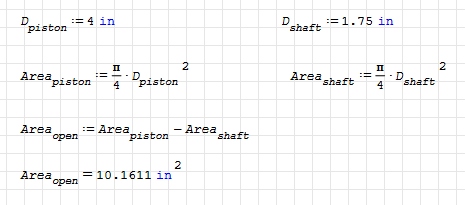

#11 Опубликовано: 16.07.2020 11:41:59
tonlok
tonlok
Once again, I want to thank everyone for their help.
I am going down the path of using the units. Took me a couple of attempts to get the in2 but it is now working
One follow-up, if I set the equation to optimization none to show the numeric values they all default to meters, is there a way to have them shown as inches?

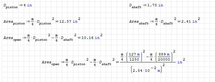

#12 Опубликовано: 16.07.2020 13:33:43
Construct as is, it may have to do with your SS version.
Otherwise, you are wrongdoing, not following guidance.
#13 Опубликовано: 17.07.2020 04:29:22
Definitions are converted to SI upon storage (you see that when you hover with the mouse over a definition. Control of display units is just by the optional placeholder, where you can insert any factor (a unit or pi or any variable name which your result may contain)
Also note that the default display unit depends on optimization. Numeric and symbolic display different units, e.g. 1/s defaults to Hz in numeric optimization and to 1/s in symbolic.
