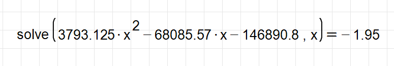

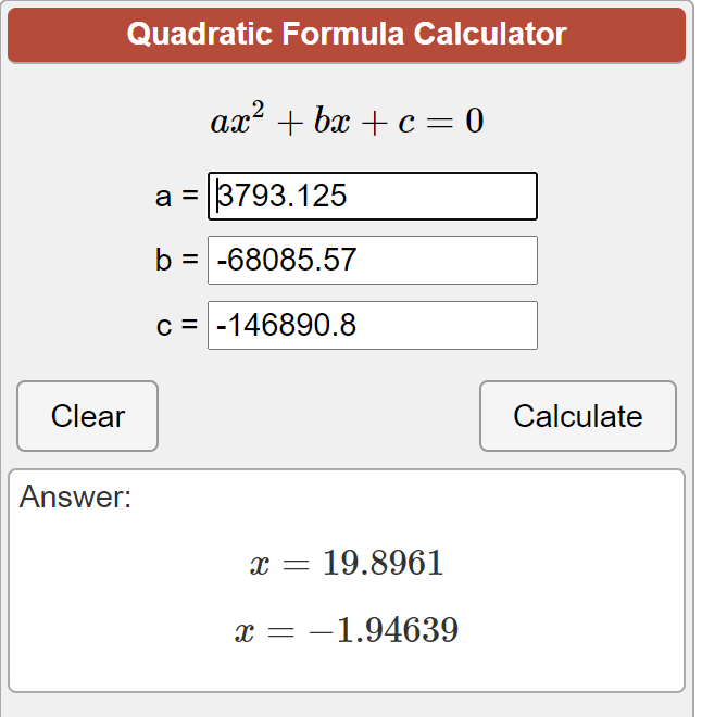

Hi, I am new to Smath Studio.
I am trying to solve a quadratic equation using solve(2) but sometimes I only get 1 number as the answer but I should be getting two numbers (see the attached files). How can I solve this problem?
Thanks in advance.

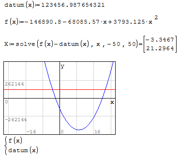

#2 Posted: 1/29/2021 8:11:37 PM
How can I solve this problem ?
1. Lagrange polynomial format is Bible in maths.
2. Always plot first.
#3 Posted: 1/29/2021 8:50:56 PM
PedS
PedS
0 likes in 6 posts.
That did the job!. Thank you
#4 Posted: 1/29/2021 9:09:38 PM
churichuro
churichuro
28 likes in 79 posts.
solo ve al menú, Herramientas->Opciones->Pestaña Calculo->y en Raices (intervalo) pon rango de -100 a 100
tecla F9 y listo
just go to the menu, Tools-> Options-> Calculation tab-> and in Roots (interval) put range from -100 to 100
push F9 and ready
