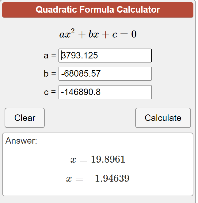

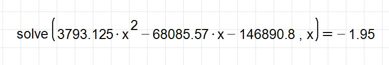

I am trying to solve a quadratic equation using solve(2) but sometimes I only get 1 number as the answer but I should be getting two numbers (see the attached files). How can I solve this problem?
Thanks in advance.

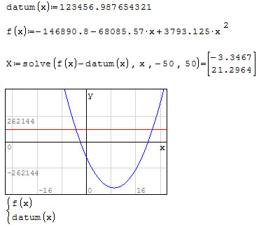

1. Lagrange polynomial format is Bible in maths.
2. Always plot first.
#3 Опубликовано: 29.01.2021 20:50:56
PedS
PedS
That did the job!. Thank you

solo ve al menú, Herramientas->Opciones->Pestaña Calculo->y en Raices (intervalo) pon rango de -100 a 100
tecla F9 y listo
just go to the menu, Tools-> Options-> Calculation tab-> and in Roots (interval) put range from -100 to 100
push F9 and ready
