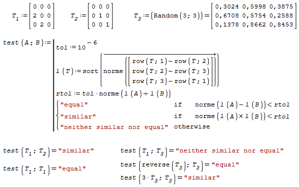

Here's a good task (test) for the SMath fans.
The coordinates of the vertices of two triangles are given.
The program returns three text messages:
1. Triangles are equal
2. Triangles are similar
3. Triangles are neither equal nor similar
#2 Posted: 6/21/2023 6:14:40 AM
1,362 likes in 2,276 posts.
Nice exercise!
ttest_Kr.sm (9.34 KiB) downloaded 1501 time(s).
Alvaro 6/21/2023 12:40:00 PM
#3 Posted: 6/21/2023 8:17:31 AM
Valery Ochkov
Valery Ochkov
67 likes in 716 posts.
Nice exercise!
