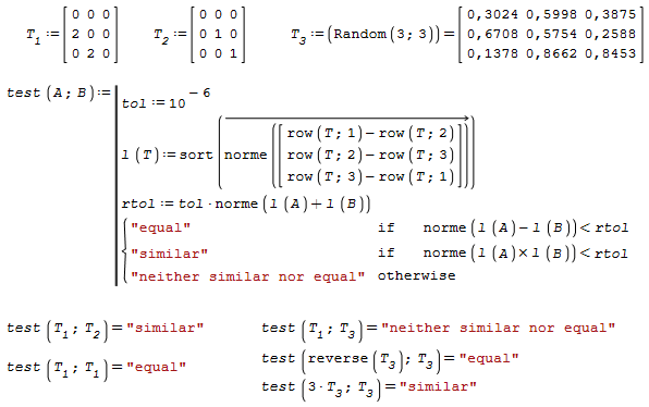

Here's a good task (test) for the SMath fans.
The coordinates of the vertices of two triangles are given.
The program returns three text messages:
1. Triangles are equal
2. Triangles are similar
3. Triangles are neither equal nor similar

WroteNice exercise!
ttest_Kr.sm (9,34 КиБ) скачан 1448 раз(а).
Thanks!
