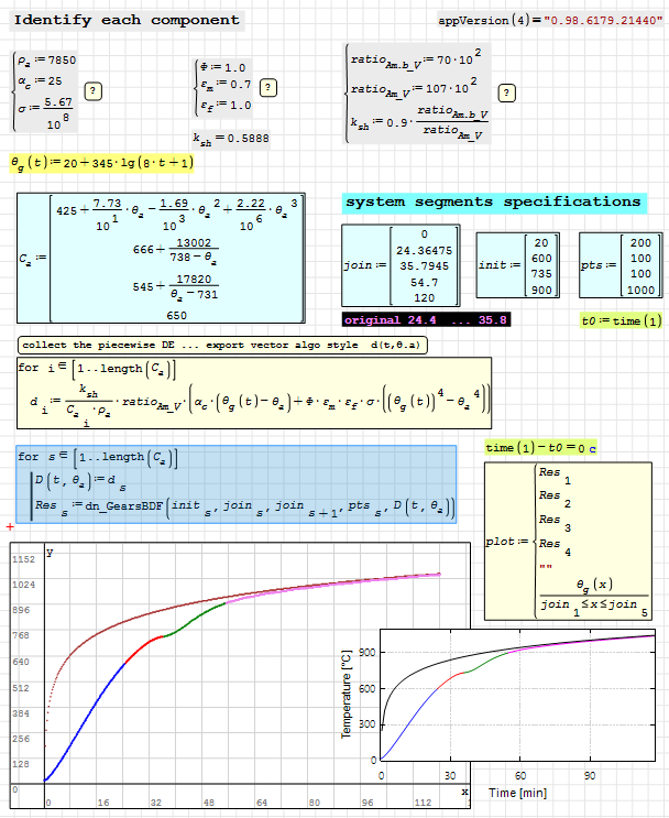

Do you mean something like "Steelfire" done/augmented a while ago ?
ODE Multiconditional [Steel fire].sm (63.85 KiB) downloaded 931 time(s).
#102 Posted: 11/7/2020 11:03:18 PM
... the compactum for loop counter is most shorter, slightly adapted.
ODE Multiconditional [Carlos Compactum].sm (26.5 KiB) downloaded 975 time(s).

#104 Posted: 11/9/2020 1:59:12 PM
I guess I've spent too much time on SMath.
Spare time to adapt your project around the more advanced ODE multi-condition.
Be careful about Bolean, sometimes tolerant but generally must be specified completely.
Mathcad was more tolerant Bolean, however had to be doctored many times in Collaboratory.
Naturally, your document is red top to bottom SS 6179.
It is so much over killed of useless, it should pass QA piecewise.
If you join visibly, no need for the TOL.
In short wrt your SS version, you must arrive at the exportable pieces.
Each piece for QA sanity check [Matlab, Mathcad ...]
ODE Multiconditional [Carlos Compactum] Copy.sm (80.79 KiB) downloaded 1034 time(s).

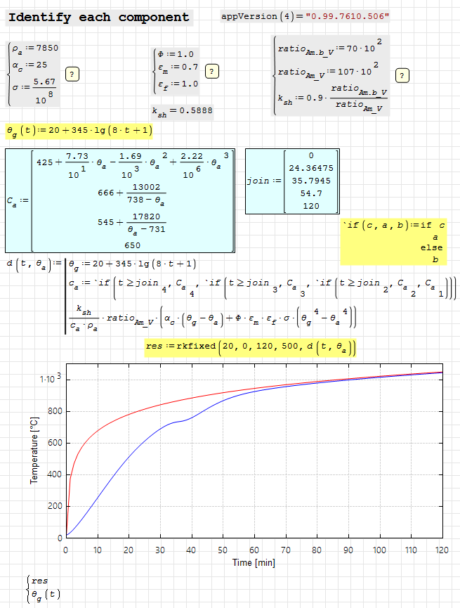

Anyway, although the document became less "techincal" after uniting all pieces in one single ODE using cases(), the project is now complete after some testing against a Excel spreadsheet I found online.
SMath community comes through once again!

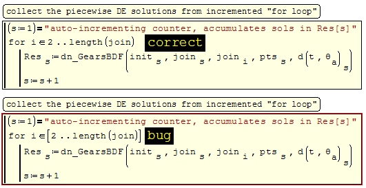

Thanks Hanski, that identifies the Smath bug.
Since which SS version, that bug exists ... ?
If you can't doctor as given, end of most Smath.
Of so many utilities that make Smath productive, the auto-increment for loop
is by large the most used and necessary. If I would update my 6179,
a great percentage of my 2500 documents would turn red hot.
Hope designers read this. If not acknowledged, will report in "Bugs"

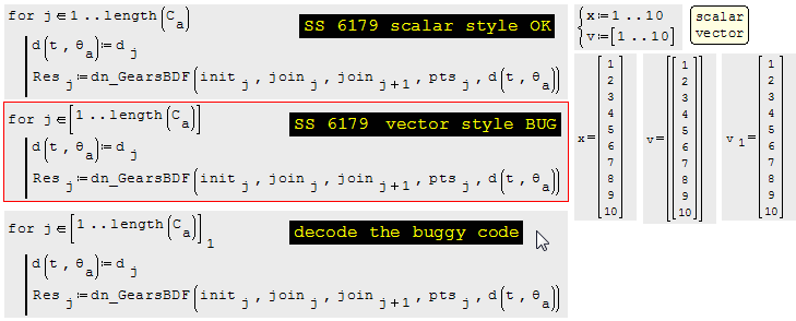

Was that bug introduced at time indexing the LHS definition 'data[i:= ...'
At work Doctors

Hello Hanski, try to decode the bug, let's see if it goes to end.

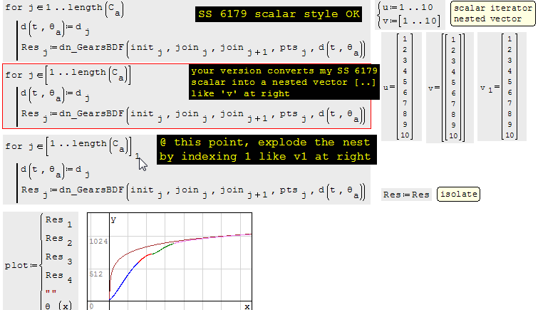

If the file format has changed and this is documented, then this is not a bug. Otherwise, you should write in the PTC forum that each new version of Mathcad destroy your old-style documents. This is non-sense to me.

1. That piece that turned red in your *.PDF, try to code as per Uni snippet.
2. Otherwise, try to doctor the damaged SS 6179 as demonstrated.
There is no justification for your SS version to convert SS 6179 scalar into nested vector.
That to me is a bug that may render zillions documents red from the Samples Repository.
Please report where you stand-in [blue sky, red document, OK].
Cheers ... Jean.

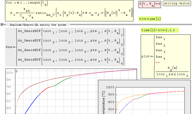

#119 Posted: 11/14/2020 11:05:50 AM
... w/o for loop, still conserving the export for QA sanity.
