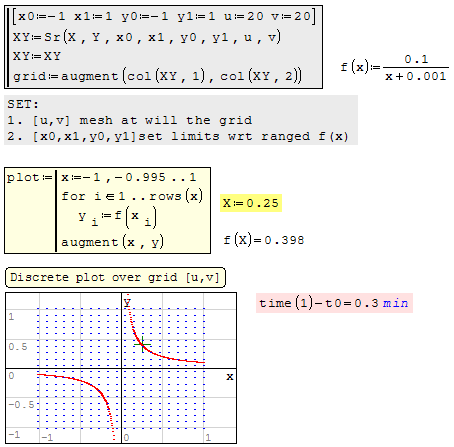

#1 Posted: 3/8/2018 1:29:59 PM
Maybe there are alternatives, this one works well.
2D Plot Discrete over Grid.sm (14.15 KiB) downloaded 1323 time(s).

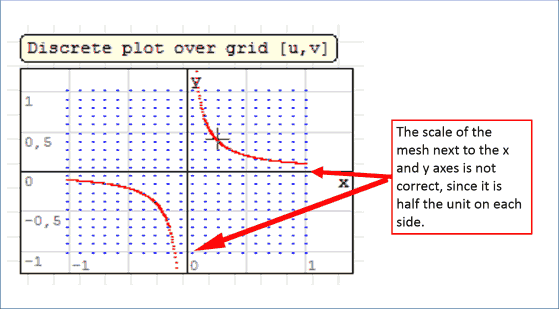

#2 Posted: 3/8/2018 6:01:32 PM
CBG
CBG
78 likes in 312 posts.
Hello Jean.
The scale of the mesh next to the x and y axes is not correct,
since it is half the unit on each side.
#3 Posted: 3/8/2018 11:29:48 PM
Hello Jean.
Easy to fix, Carlos ... like this.
It's normal the [XY axes] don't split exactly ½ way in
between the grid. Grid is 9 pixels, the native QuickPlot
grid spacing is 41 pixels. Handles will give either 40/41
but not 40.5. However, far superior to Mathcad/Mathsoft.
2D Plot Discrete over Grid.sm (16.54 KiB) downloaded 1356 time(s).

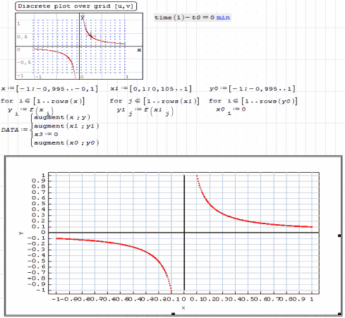

#4 Posted: 3/9/2018 7:14:36 PM
CBG
CBG
Hello Jean
Graph of the function in X Y plot
2D Plot Discrete over Grid_CBG.sm (21 KiB) downloaded 1320 time(s).
