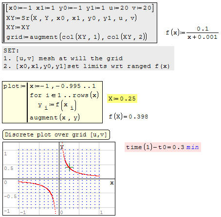

Maybe there are alternatives, this one works well.
2D Plot Discrete over Grid.sm (14,15 КиБ) скачан 1133 раз(а).

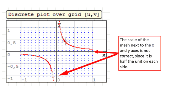

Hello Jean.
The scale of the mesh next to the x and y axes is not correct,
since it is half the unit on each side.
#3 Опубликовано: 08.03.2018 23:29:48
Hello Jean.
Easy to fix, Carlos ... like this.
It's normal the [XY axes] don't split exactly ½ way in
between the grid. Grid is 9 pixels, the native QuickPlot
grid spacing is 41 pixels. Handles will give either 40/41
but not 40.5. However, far superior to Mathcad/Mathsoft.
2D Plot Discrete over Grid.sm (16,54 КиБ) скачан 1182 раз(а).

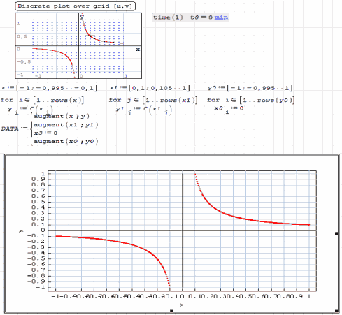

#4 Опубликовано: 09.03.2018 19:14:36
CBG
CBG
Hello Jean
Graph of the function in X Y plot
2D Plot Discrete over Grid_CBG.sm (21 КиБ) скачан 1144 раз(а).
