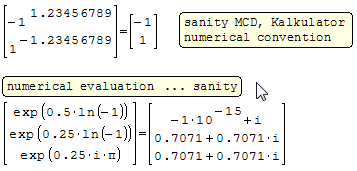

#2 Posted: 10/15/2018 3:49:48 PM
The default convention is a bug by itself.
That it does not default to "convention" suggests incomplete user coding.
Maths Exp(,) Convention.sm (26.12 KiB) downloaded 1383 time(s).

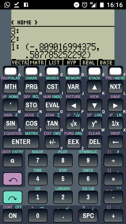

#3 Posted: 10/15/2018 6:23:14 PM
1,139 likes in 1,805 posts.
Calculators given the same answer. Here Droid 48 for Android

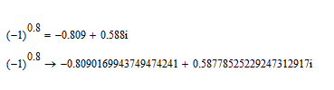

#4 Posted: 10/15/2018 9:03:34 PM
Just some mistake.
Strictly a bug. Visit l'Hospital rules and the likes.
i.e: this undetermined is determined.

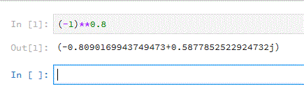

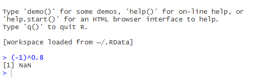

Mathcad
Python
R
