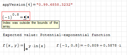

#1 Posted: 10/15/2018 1:08:46 PM
Hi. Just some mistake.
Potential-exponential function error.sm (4.07 KiB) downloaded 1384 time(s).

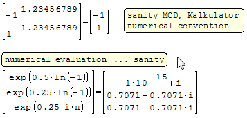

#2 Posted: 10/15/2018 3:49:48 PM
The default convention is a bug by itself.
That it does not default to "convention" suggests incomplete user coding.
Maths Exp(,) Convention.sm (26.12 KiB) downloaded 1350 time(s).
