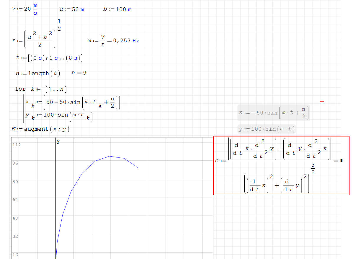

Hello everyone!
I have difficulty plotting the function c which depends on the derivatives of two functions which in turn depend on the parameter t.
Could anyone help me? This in the smath file.. curvatura.sm (11.36 KiB) downloaded 1639 time(s).
Thank you so much

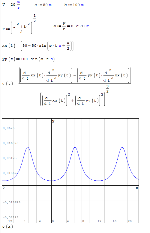

Hello everyone!
I have difficulty plotting the function c which depends on the derivatives of two functions which in turn depend on the parameter t...
Maybe this is what you want...
... and the .sm file: curvatura1.sm (9.4 KiB) downloaded 1686 time(s).

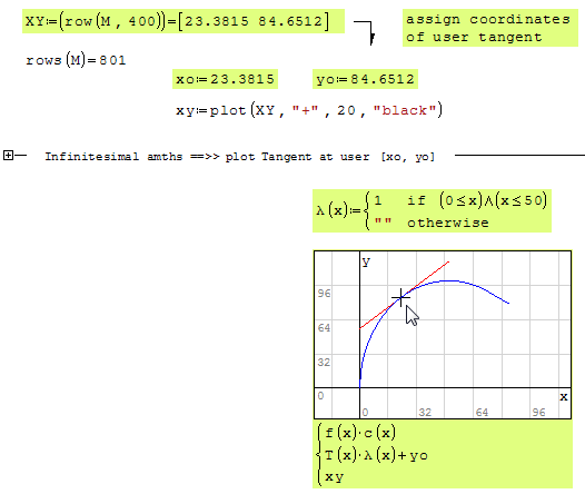

#7 Posted: 12/6/2019 12:48:15 PM
1,139 likes in 1,805 posts.
Hi Ale. Here, some ways.
curvatura3.sm (25.1 KiB) downloaded 1686 time(s).
curvatura4.sm (20.83 KiB) downloaded 1675 time(s).
sergio 12/6/2019 5:23:00 PM
#8 Posted: 12/6/2019 1:08:58 PM
Thank you very much for the availability.
But I need more help.
How can I draw the tangent line to the equation in parametric form?
For the Tangent over C(t), it will follow the scalar rules
of the document Tangent.sm posted before.
The Tangent over the parabola is another business.
Smath does not derive linterp(x) as it is NOT a function
only an interpolation. This project and lot more are
rescued via Infinitesimal Analysis [dates back before CAS].
For that particular typical user point of tangency, OK.
You may want to experiment more .
Don't mind to see noisy curvature [disabled in collapsed].
Chers ... Jean.
curvatura2 Copy.sm (30.56 KiB) downloaded 1666 time(s).

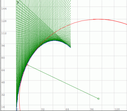

#9 Posted: 12/6/2019 1:16:01 PM
Ale16595
Ale16595
0 likes in 35 posts.
Thanks for the answers.
But if I wanted to find the tangent to the curve when the parameter t changes, how should I do?
#10 Posted: 12/6/2019 2:05:01 PM
Do you mean the envelope, all the tangents for the range en T?
curvatura5 - envelope.sm (23.64 KiB) downloaded 1553 time(s).
Best regars.
sergio 12/6/2019 5:19:00 PM
#11 Posted: 12/6/2019 2:55:53 PM
Thanks Alvaro ... superb/saved ... Jean
