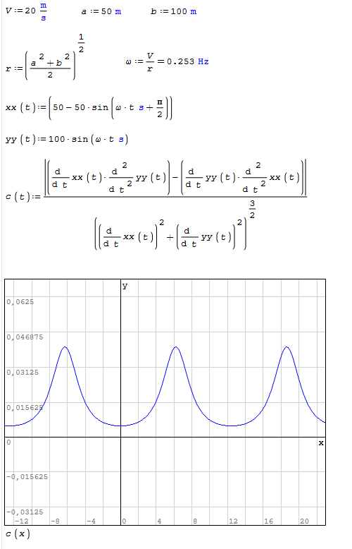

Hello everyone!
I have difficulty plotting the function c which depends on the derivatives of two functions which in turn depend on the parameter t.
Could anyone help me? This in the smath file.. curvatura.sm (11,36 КиБ) скачан 1639 раз(а).
Thank you so much
#2 Опубликовано: 04.12.2019 17:37:09
Oscar Campo
Oscar Campo
Hello everyone!
I have difficulty plotting the function c which depends on the derivatives of two functions which in turn depend on the parameter t...
Maybe this is what you want...
... and the .sm file: curvatura1.sm (9,4 КиБ) скачан 1686 раз(а).

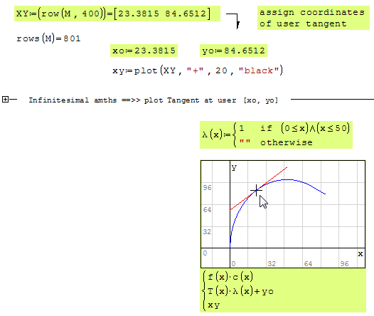

But I need more help.
How can I draw the tangent line to the equation in parametric form?
this is the file … curvatura2.sm (12,5 КиБ) скачан 1727 раз(а).
#7 Опубликовано: 06.12.2019 12:48:15
Hi Ale. Here, some ways.
curvatura3.sm (25,1 КиБ) скачан 1686 раз(а).
curvatura4.sm (20,83 КиБ) скачан 1675 раз(а).
sergio 06.12.2019 17:23:00
#8 Опубликовано: 06.12.2019 13:08:58
Thank you very much for the availability.
For the Tangent over C(t), it will follow the scalar rules
of the document Tangent.sm posted before.
The Tangent over the parabola is another business.
Smath does not derive linterp(x) as it is NOT a function
only an interpolation. This project and lot more are
rescued via Infinitesimal Analysis [dates back before CAS].
For that particular typical user point of tangency, OK.
You may want to experiment more .
Don't mind to see noisy curvature [disabled in collapsed].
Chers ... Jean.
curvatura2 Copy.sm (30,56 КиБ) скачан 1666 раз(а).

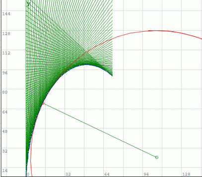

But if I wanted to find the tangent to the curve when the parameter t changes, how should I do?
#10 Опубликовано: 06.12.2019 14:05:01
Thanks for the answers.
Do you mean the envelope, all the tangents for the range en T?
curvatura5 - envelope.sm (23,64 КиБ) скачан 1554 раз(а).
Best regars.
sergio 06.12.2019 17:19:00

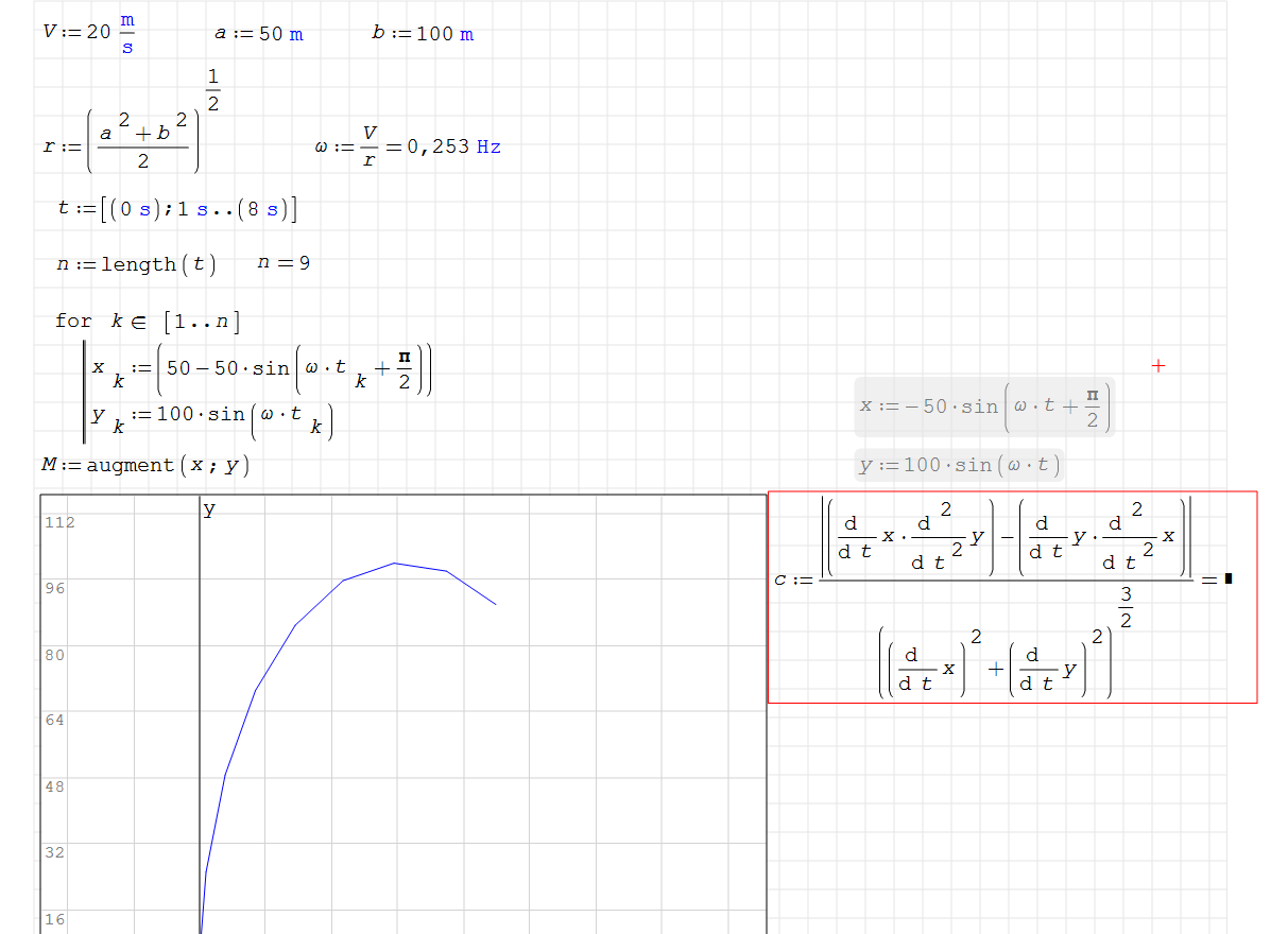

#13 Опубликовано: 06.12.2019 22:48:04
Your project has been refactored strictly on discrete.
OK, you have functions but life is from collected data.
Collected data are always noisy from the quantization,
a small amount of Gaussian Ksmooth is often sufficient.
Ksmooth being applied before cinterp
As exemplified, cinterp is the best interpolator for
a clean curvature plot from infinitesimal maths.
I don't understand what your were attempting c(t) last module.
Please, don't hesitate for more.
Maths Tangent Data Set Copy.sm (36,61 КиБ) скачан 1646 раз(а).

#16 Опубликовано: 07.12.2019 10:48:24
Thank you very much for the help, I appreciate it very much.
I hope to be able to continue alone.
kind regards
Your project now all done, based on discrete collected data,
collected data that you will have to smooth [not offered].
Smoothing is a large Engineering tool box !
Let's see the continued adventure.
Maths Tangent Data Set.sm (60,84 КиБ) скачан 1627 раз(а).
sergio 07.12.2019 11:50:00
