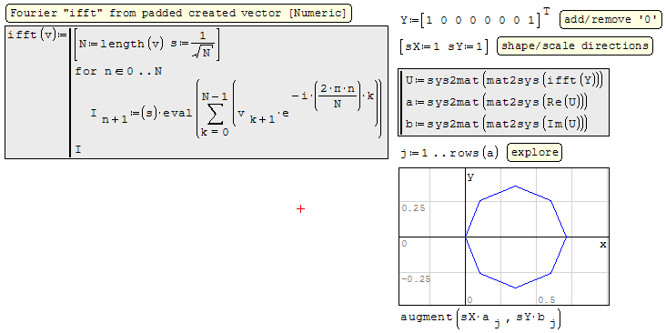

... you may not need the transition.

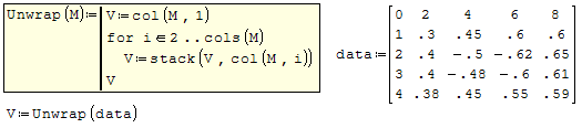

The Unwrap(M) algo is commonly used in projects.
#7 Posted: 4/28/2022 8:10:12 AM
598 likes in 1,380 posts.
Unwrap() is not what owner of topic asked. Non-relevant.

There is a good reason to collect a project in system.
You can add/remove ... once collected or at time of collection.
... augment by clicking on the place holder of system.
... push down from top
... insert .
The attached example was collected this way by the Originator.
Simply plotting a zombie parrot from conversion.
At this point, the appropriate adjacency matrix was designed,
resulting in the desired W truss.
Collaboration appointed several visits ... done.
If you have something specific on the design board, let's go.
Cheers ... Jean.
