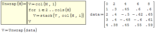

#6 Опубликовано: 28.04.2022 08:09:13
The Unwrap(M) algo is commonly used in projects.
#7 Опубликовано: 28.04.2022 08:10:12
Unwrap() is not what owner of topic asked. Non-relevant.

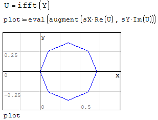

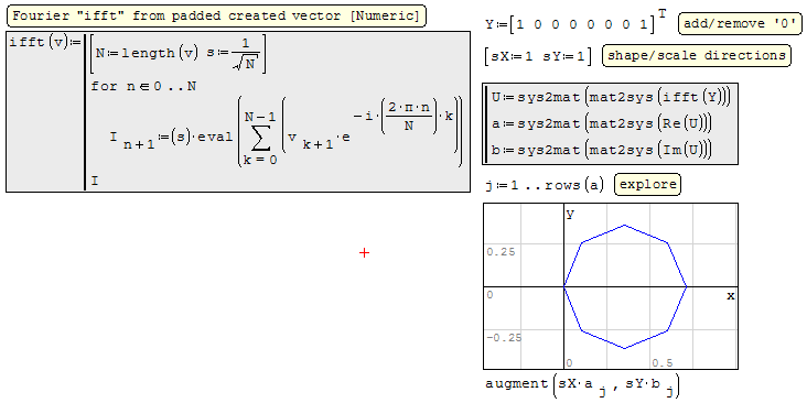

#9 Опубликовано: 28.04.2022 11:47:25
Dear friends, is there a function to convert a "sys" to a "vector" and a function to convert a "vector" to a "sys"?
There is a good reason to collect a project in system.
You can add/remove ... once collected or at time of collection.
... augment by clicking on the place holder of system.
... push down from top
... insert .
The attached example was collected this way by the Originator.
Simply plotting a zombie parrot from conversion.
At this point, the appropriate adjacency matrix was designed,
resulting in the desired W truss.
Collaboration appointed several visits ... done.
If you have something specific on the design board, let's go.
Cheers ... Jean.
