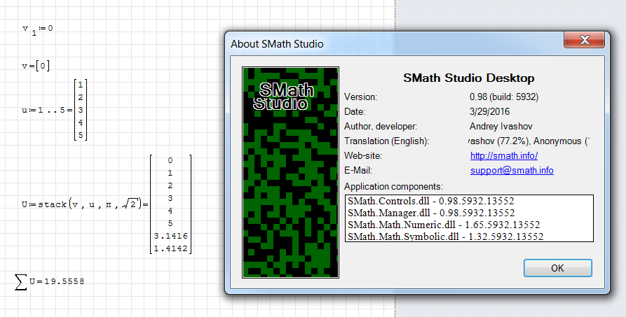

#1 Posted: 3/31/2016 11:02:59 AM
Working with "stack"

Makes me wonder if summation (and other) error(s) for the result of stack is a bug that needs to be resolved
Actually nevermind, this seems to be resolved in the latest build:
P.S.: love the new square [] brackets for matricies

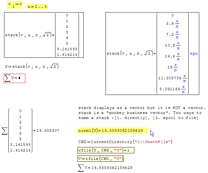

#3 Posted: 3/31/2016 1:25:24 PM
... I can see some "improvement" ? in your latest Smath.
The old style is valid too, more flexible ? to be checked

#5 Posted: 3/31/2016 9:21:24 PM

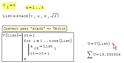

Unlike "augment" that is a conclusive operation, "stack" is not a conclusive operation.
Unless "List is vectorised", as defined it is NOT a vector even if it displays as vector.
"List is a scalar vector". So, it won't sum. The module V(List) creates "List" as a vector,
then suited for sum. In the definition u:=1..5 ,,,, u is anything and nothng unless ASSIGNED
active [per say valued]. That's why the error message "Must be a vector" .
"Must be a vector" whether by the vectorising operator or by user creation.
