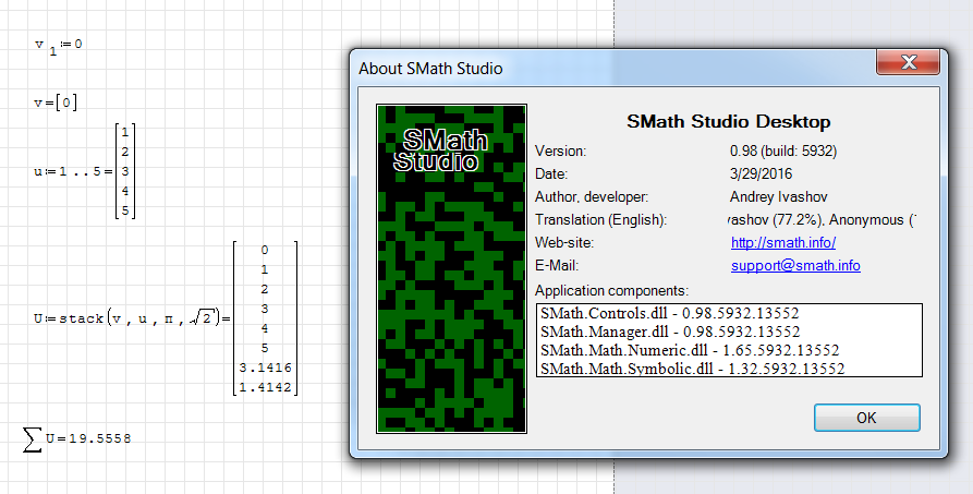

Wrote... I can see some "improvement" ? in your latest Smath.
Pun intended ? Did not get this. Also it is not "my Smath" by any stretch - all is Andrey's hard work.
Anyway I did not get your post - just my slow mind I guess.

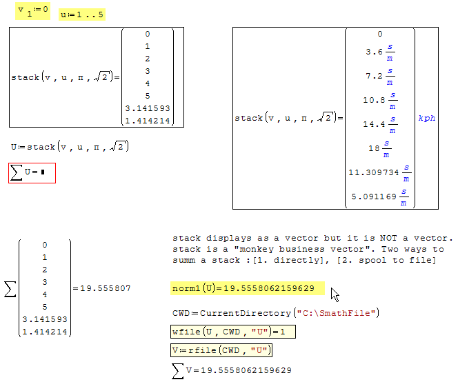

Unlike "augment" that is a conclusive operation, "stack" is not a conclusive operation.
Unless "List is vectorised", as defined it is NOT a vector even if it displays as vector.

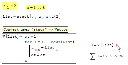

"List is a scalar vector". So, it won't sum. The module V(List) creates "List" as a vector,
then suited for sum. In the definition u:=1..5 ,,,, u is anything and nothng unless ASSIGNED
active [per say valued]. That's why the error message "Must be a vector" .
"Must be a vector" whether by the vectorising operator or by user creation.
