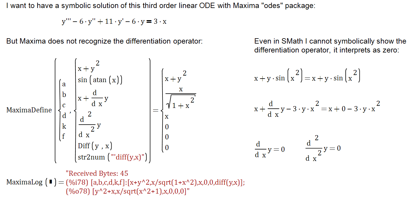

Do you know why or what could be the problem for SMath not translating properly a dy/dx. I need to write these operators in Maxima to solve a differential equation...
Thanks in advance,
Differentiation.sm (9.34 KiB) downloaded 1124 time(s).
Thanks in advance,

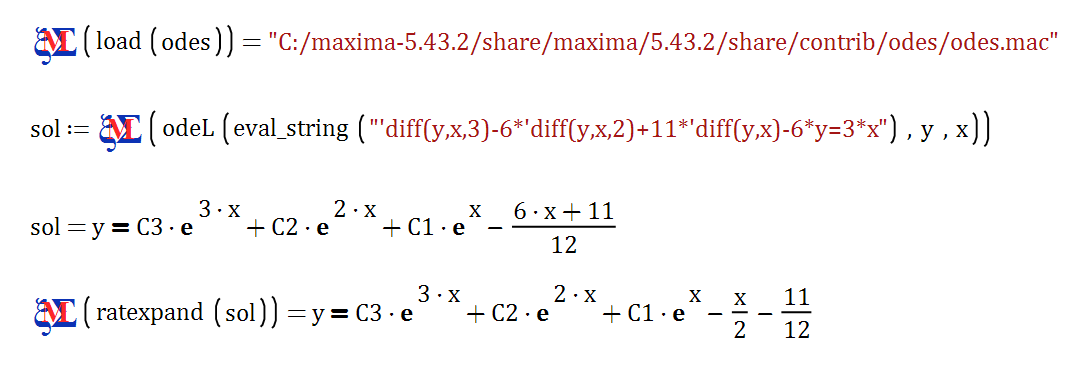

I have found a workaround, with eval_string() from Maxima.
Differentiation.sm (13.39 KiB) downloaded 1130 time(s).

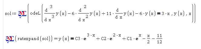

#3 Posted: 5/30/2020 11:55:54 PM
WroteHello,
Hola tocayo. Is this the problem?: always it is diff(y,x)=0, but diff(y(x),x) remains unevaluated and is the correct form to express the derivative of a function.
frapuano 5/31/2020 4:51:00 AM

You are mixing two CAS that will not pass QA [Quality Assurance].
My understanding is that what was usable from Maxima is native in Smath.
Smath native derivative operator works from book library.
sin(x), ln(x), exp(x) ... OK
Gamma(x), erf(x) ... zap. We have them otherwise.
Differentiation.sm (17.82 KiB) downloaded 1140 time(s).
