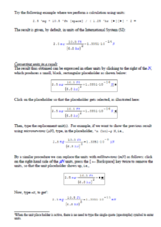

Nmm²:=1 ....... a:= 2, b:=2 .... a+b=4Nmm²
#3 Posted: 10/27/2017 1:57:22 PM
CBG
CBG
78 likes in 312 posts.
See the Handbook in Tools--plugins--handbooks--Introduction to Smath Studio by Gilberto E. Urroz, page 17

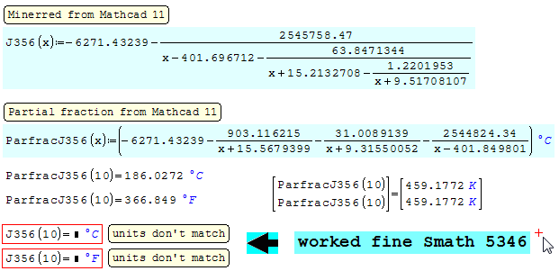

Attached are two typical Engineering projects that don't use unit system.
Standards are given in the appropriate unit system. So, you just need to
append the "UnitResult" accordingly to the formulation.
"Uconeer" is a freeware unit conversion software from "Katmar".
From "Katmar" you can get WASP [Water and Steam Properties]
Free use for 2 min session.
On the other hand, Smath unit system has changed from Smath 5346 to
Smath 6179 ... that freaks many of my projects.
I started Mathsoft Collaboratory day 1 for over 125000 visits.
1000's projects were done [Engineering/Scientific], not a single one
was carried with units.
