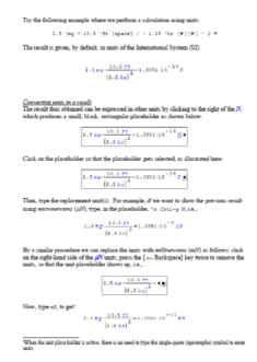

I have unis for example:
a=2MPa
b=2N/mm2
a+b=4*10e6 Pa
How can I obtain the answer in N/mm2, not in Pa. Is it possible. In Mathcad simple change the units, but it's a pity here it doesn't work. Thank You for reponse. Paulius

Nmm²:=1 ....... a:= 2, b:=2 .... a+b=4Nmm²

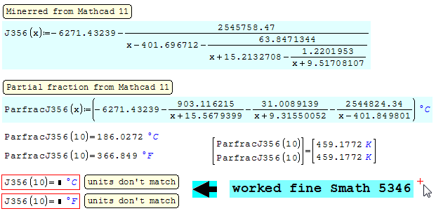

Attached are two typical Engineering projects that don't use unit system.
Standards are given in the appropriate unit system. So, you just need to
append the "UnitResult" accordingly to the formulation.

On the other hand, Smath unit system has changed from Smath 5346 to
Smath 6179 ... that freaks many of my projects.
