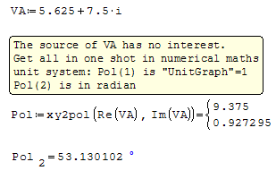

#10 Posted: 6/5/2016 7:57:34 PM
In this specific set of applications I have no interest in "numerical MathEMATICS". [Basile]
From A...Z, Smath is a numerical math tool as any other CAS and including your specific application.
xy2pol result is a vector of two components that need no unit as they are implicit. Extract each
component and append a dead unit decoration for clarity to yourself and the reader.

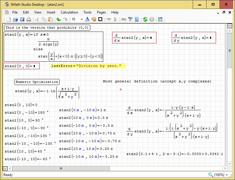

WroteNotice that atan2 ins't in SMath, which is more correct than atan for this functions (see http://www.mathworks.com/help/matlab/ref/atan2.html for example).
atan2.sm (35.42 KiB) downloaded 1317 time(s).
С уважением,
Михаил Каганский

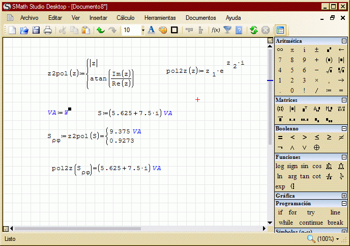

#12 Posted: 6/5/2016 8:58:58 PM
Hi Mike. I prefer this other, but have some round inconvenients:
#13 Posted: 6/5/2016 9:04:35 PM
WroteI guess that with the new try function samebody can make a good one atan2.
But with try, it won't differentiate again.
С уважением,
Михаил Каганский
#14 Posted: 6/5/2016 9:10:02 PM
WroteWroteI guess that with the new try function samebody can make a good one atan2.

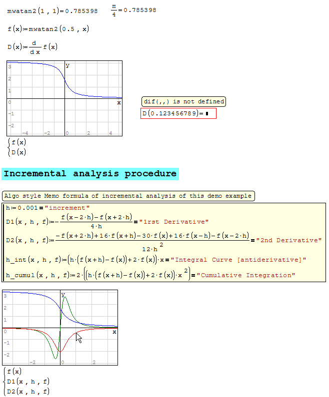

#16 Posted: 6/6/2016 10:11:40 AM
Like this Alvaro: look for the Matlb code in the f(x) menu,
look for mwatan2 ... if you have in your version: then go
Maths atan2.sm (10.93 KiB) downloaded 1385 time(s).
