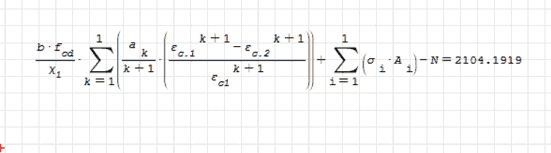

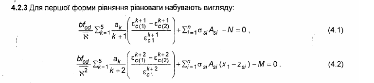

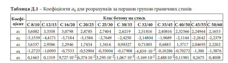

I have one formula where it is necessary to make a sum in a way that takes into account 5 coefficients of a polynomial. In the sum he is marked as ak and I need that instead of ak there was a1..a2..a3 ... a4 ... a5. Also, for each polynomial account, the power K automatically changes from the index of the polynomial 1..2..3..4..5. How to implement it in this program? Also, I have several layers of reinforcement in the equation that should also be instead of Asi to As1...As2...As3...Asn and Sigma_si to Sigma_s1...Sigma_s2...Sigma_s3...Sigma_sn . Sorry for bad English.

You have 11 sets of 'a'
Easy to tabulate, is it what you want ?

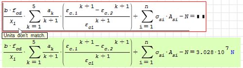

Pl look at this. Error may have occurred when entering the formula???? Difficult to trace.
Unable to select individual components of the erroneous formula.
There it seems the formula is ill posed wrt [4.1].
It shows bfcd as something not defined but the originator
has defined b, and defined fcd ... b*fcd.
