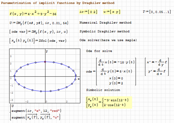

An easy setup for the uni's Draghilev method for plot implicit plane curves.
dm_revisited_correct.sm (34.71 KiB) downloaded 2001 time(s).

Thanks you, Ber. Just an apologize, I upload the first time the wrong file, where I use for(3), the correct is this one, with for(4) arguments version (with for(3) seems that you can't change the iterating variable in the body of the loop, but for(4) do that).
This have not effect in the function DM.2(f(2),uo,ho,N), which use RK2 method, but solve an issue in DM.2(f(2),uo,ho,N,K)
dm_revisited_correct.sm (34.71 KiB) downloaded 1897 time(s).
With the last argument different from 0 you call a RK5, which colud be faster for some figures:

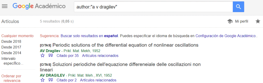

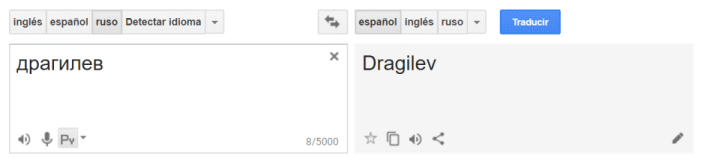

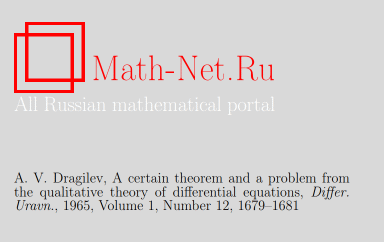

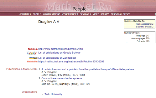

Thanks! It's very important use the correct reference. But actually I'm not sure about the correct name: Google traductor isn't an authority for me, and I prefer to trust in your knowledge, but:
Translating to spanish it is: https://translate.google.com.mx/#ru/es/%D0%B4%D1%80%D0%B0%D0%B3%D0%B8%D0%BB%D0%B5%D0%B2
To english, from http://forum.exponenta.ru/f-x-0-t3892.html
From google academic: https://scholar.google.com/scholar?hl=es&as_sdt=0%2C5&q=author%3A%22a+v+dragilev%22&btnG=
Form http://www.mathnet.ru/php/person.phtml?&personid=32359&option_lang=eng
and ( http://www.mathnet.ru/links/3c8499a4720a6eb7bcfc74a0694d5b23/de9397.pdf )
and some others.
Maybe someone can contact the author or some friend of him.

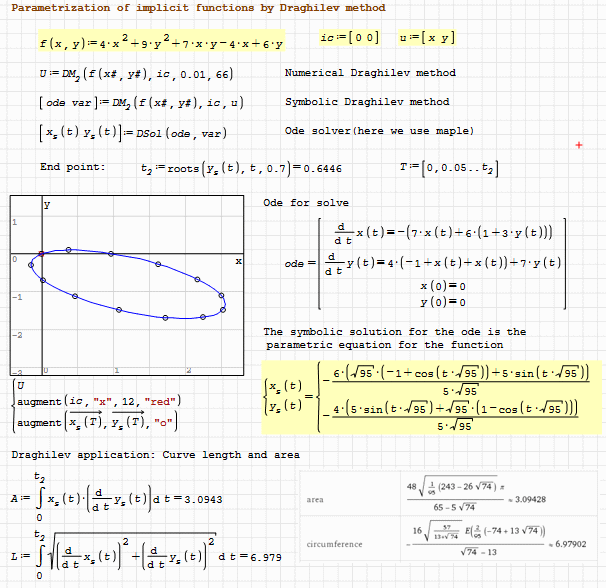

Hi. I post this example of the uni's procedure implementation because not just it's more easy for some curves, but it show that we don't need to use the parameter, even the original procedure talks about the parametrization of the curve (one of them, the other, as uni explain in other forums, and apply he and others here, is for search intersection of curves).
Both Runge Kutta algorithms RK2 and RK5 in the numerical procedure don't achieve the "time", this is, the parameter, and the function D(t,x) usual in the rk solvers is just D(x) formed only by elements of the jacobian. This situation seems to me that even the algorithms came from derivatives, looks more like a global property of the function more than a local one, like the case of the derivative (local) and it inverse, integration (global).

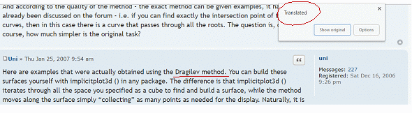

By the way, I have seen Uni in the PTC forum, specifically about Draghilev

Hi.
I don't see there a full explanation about the Draghilev method. I see only an application for the method, the seek for roots of a system of equations. That could give a poor idea about the meaning, importance and interpretation of the method.
The method it's about the parametrization of a function f:R^n -> R.
For instance think at anything more easy to do with the parametric equations rather than cartesians, and you get a new application for the Draghilev method.
In this file, maple is used only as symbolic solver for the ode's.
dm.sm (84.52 KiB) downloaded 1922 time(s).
