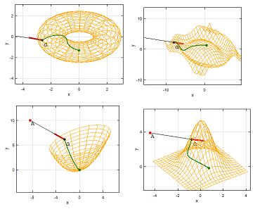

#67 Posted: 4/2/2019 3:52:56 PM
Fridel Selitsky
Fridel Selitsky
520 likes in 451 posts.
Finding Distance of a Point from Surface
The difference from the program distance to the curve in only one expression:
in the top line instead of i: = (1 ... 2)) we have i: = (1 ... 3).
A is a given point, a is its projection to the surface, Аa (k) is the length of the segment Аa (k)
to the surface, the h-step of decreasing the distance, a (k) is the intermediate coordinate of
the point touch.The red line is the normal, the green is the trajectory of the movement of the
point a (k) from the initial the position of a (1) to the final a.I borrowed the trajectory
demonstration from Razonar,to whom I express my gratitude.
Dist3d.sm (63.12 KiB) downloaded 1718 time(s).
4 users liked this post
Вячеслав Мезенцев 4/2/2019 6:23:00 PM, Alvaro 4/2/2019 5:46:00 PM, NDTM Amarasekera 4/3/2019 12:15:00 PM, Andrey Ivashov 4/3/2019 3:23:00 AM

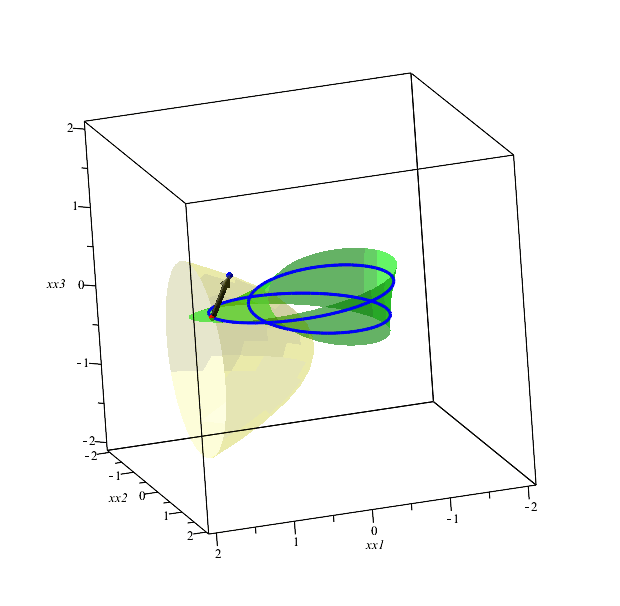

#73 Posted: 4/5/2019 9:15:14 AM
алексей
алексей
17 likes in 78 posts.
“Finding Distance of a Point from curve or surface” - not far the best application of the Draghilev method.
An example of the projection of points from one surface to another using the optimization methods in Maple.

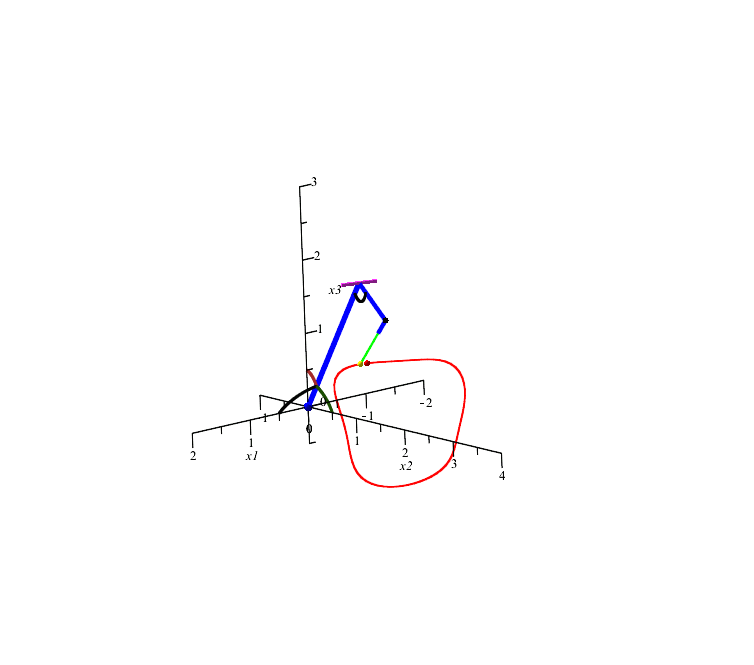

#75 Posted: 4/5/2019 2:41:42 PM
алексей
алексей
It seems to me that the Draghilev method is intended for a “large” number of variables with a “small” number of equations.
For example, as in the case of solving the inverse problem of kinematics for a three-link manipulator with a variable length of the working link. This manipulator has 6 degrees of freedom.

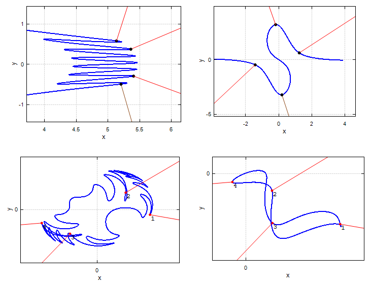

#77 Posted: 10/2/2020 3:43:22 PM
Fridel Selitsky
Fridel Selitsky
Point Orthogonal Projection onto a flat or spatial Curve
Calculation procedure
1. We will use Draghilev's method
a) to parameterizethe curves and find a good initial guess.
We will use the point a0, found by the minimum distance
from the curve to a given point P.
b) to calculate the unit vector of the tangent T (x) to a
point on the curve.
2 To the system of equations we add an equation that
expresses the conditions of perpendicularityof the tangent
at the point x of the curve and the segment connecting the
points P and x. This means that the inner product of the unit
tangent vector to the curve f (x) and the unit vector Px is
equal to zero. As a result, we obtain the system of equations
3. We solve the system with the initial assumption a0
distantion.sm (124.14 KiB) downloaded 1747 time(s).
Trascidental curves.pdf (394.93 KiB) downloaded 1056 time(s).

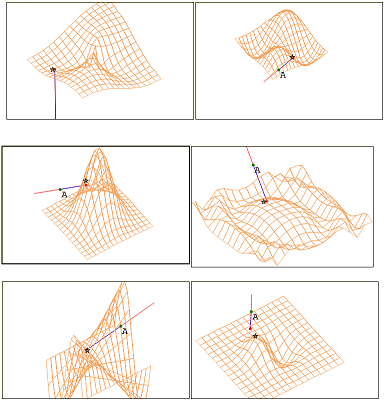

#79 Posted: 12/2/2020 6:12:07 AM
Fridel Selitsky
Fridel Selitsky
Distance and projection of a point onto a parametric surface
ParSur.sm (74.98 KiB) downloaded 1898 time(s).
ParSur.pdf (619.79 KiB) downloaded 1261 time(s).
Alvaro 12/2/2020 6:21:00 PM
