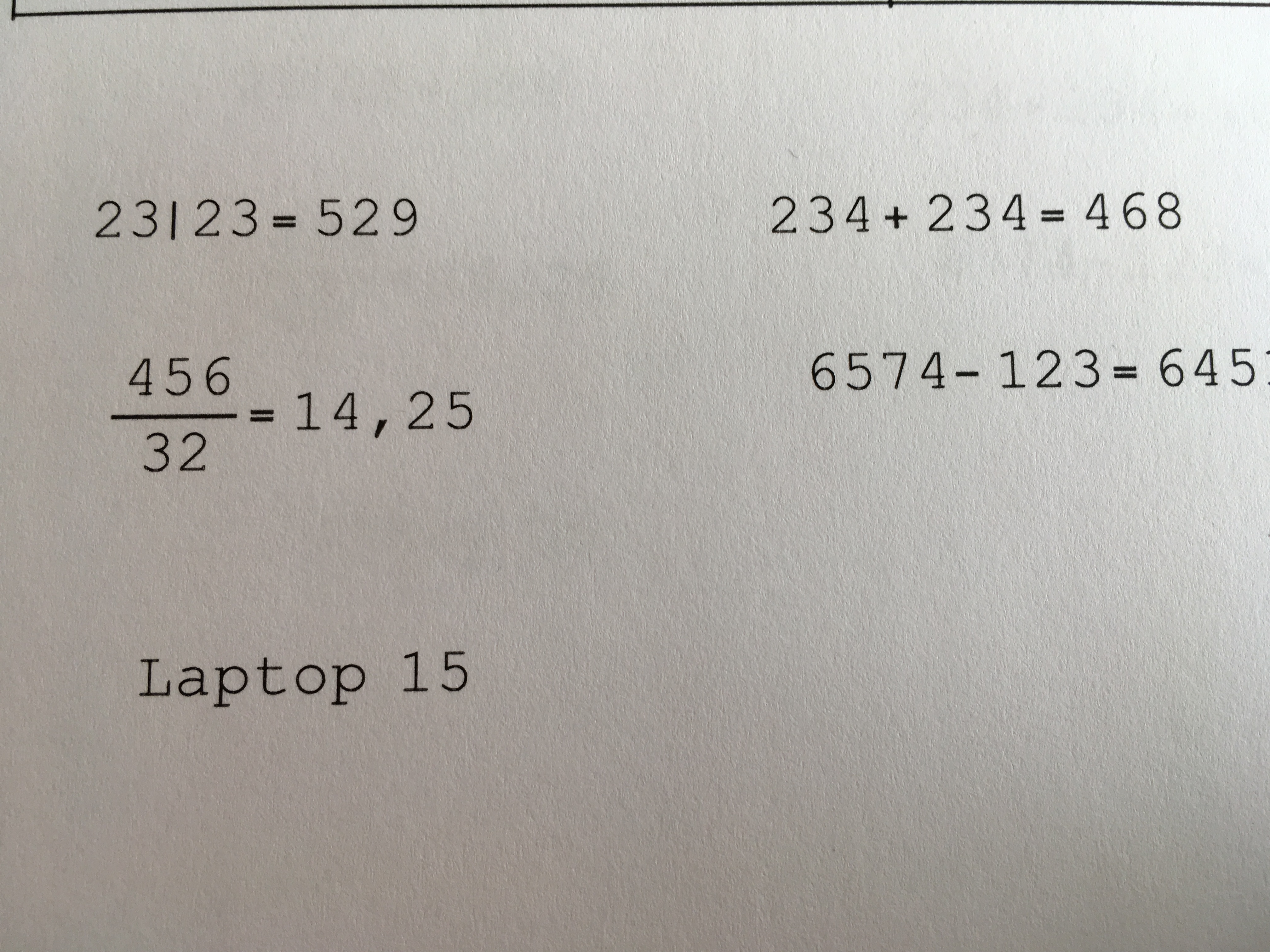

Hello everybody,
when my students print their SMath files it appeares that some of the printouts does not show the arithmetic operator fro multiplication "*" but instead the "|" line instead.
I did install the program from USB-stick, so all laptops have the same version. After install we did not alter any setups. And all Laptops print 2 the same printer. And further are all laptops of the same type/modell including OS (Win10).
Any suggestions, why some prints show the arithmetic operator and others not...?

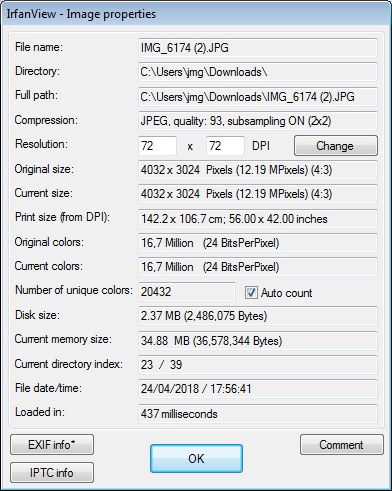

#7 Posted: 4/24/2018 7:07:52 PM
Any suggestions
Rather questions:
1. 2.5 MB for 4 simple arithmetic ?
2. What generates the gray background ?
3. Is that what it prints ? Visibility is around 7 % zoom down
4. Check the keyboard style as well.

#10 Posted: 4/30/2018 7:53:57 AM
DirkOS
DirkOS
0 likes in 4 posts.
Any suggestions
Rather questions:
Sry for the unconvenience, i took a picture!
