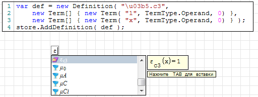

#2 Posted: 3/23/2017 5:05:17 AM
1,554 likes in 1,864 posts.
Yes, you can.
Script:
Show Spoiler
#3 Posted: 3/23/2017 6:08:08 AM

Thank you again - now I see that it can be done but your answer results in two more questions:
1) How are you including C# code in Smath region? Is it just print screen or real code in some type of region which is evaluating on fly? Looks like magic for me (in MathCAD it is impossible to do such things).
2) You are using Definition and Store classes. During searching in example plugins I found that there are used mainly in customizable controls. I am developing some sort of functions by implementing IPluginHandleEvaluation interface.

#4 Posted: 3/23/2017 7:06:40 AM
Quote
Yes, the code is executed on the fly. This is just a Script region.
Quote
This is features of Script region. In your case, you have to write it differently. I just showed that this will work.
