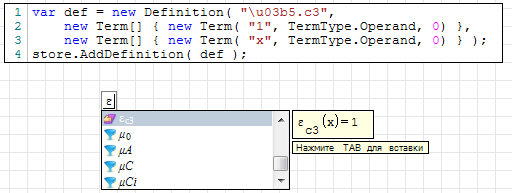

#2 Опубликовано: 23.03.2017 05:05:17
Yes, you can.
Script:
Показать спойлер

Thank you again - now I see that it can be done but your answer results in two more questions:
1) How are you including C# code in Smath region? Is it just print screen or real code in some type of region which is evaluating on fly? Looks like magic for me (in MathCAD it is impossible to do such things).

#4 Опубликовано: 23.03.2017 07:06:40
Yes, the code is executed on the fly. This is just a Script region.
