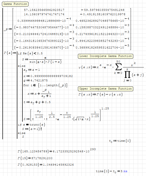

Gamma function,
Lower Incomplete Gamma function,
Upper Incomplete Gamma function,
with almost instant speed and high precision.
gamma.sm (34.69 KiB) downloaded 1443 time(s). <---- least accurate
gamma_r2.sm (11.52 KiB) downloaded 1434 time(s).
gamma_r3.sm (11.8 KiB) downloaded 1430 time(s).
gamma_r4.sm (13.82 KiB) downloaded 1433 time(s).
gamma_r5.sm (11.38 KiB) downloaded 1476 time(s).
gamma_r6.sm (17.75 KiB) downloaded 1397 time(s).
gamma_r7.sm (28.8 KiB) downloaded 1516 time(s).
gamma_r8.sm (31.51 KiB) downloaded 1539 time(s).
gamma_r9.sm (36.93 KiB) downloaded 1934 time(s). <----imaginary numbers added

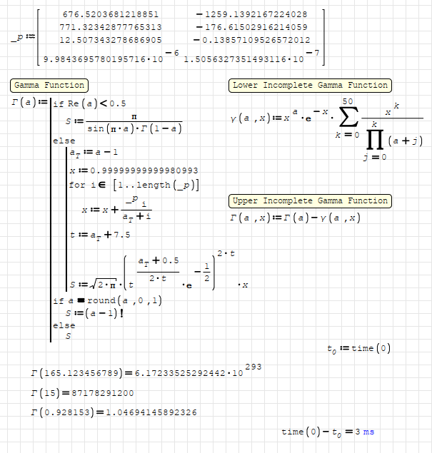

#5 Posted: 6/8/2021 8:34:03 PM
600 likes in 1,381 posts.
Technically this should be the most accurate one.

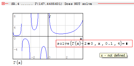

#6 Posted: 6/8/2021 9:34:29 PM
As offered ... two applications.
Now, the old Rooster is going in the bed marmite ... Jean.
gamma(a,x) Applications.sm (23.56 KiB) downloaded 1359 time(s).

#8 Posted: 6/9/2021 1:46:58 PM
I suggest you to change gamma function with gamma_r4.
It is 3 times faster and much more precise.
Thanks for gamma_r4
1. NO gain timing both applications
2. gamma_r4 Does NOT solve ... first version solves.
#9 Posted: 6/9/2021 2:06:13 PM
Thanks for gamma_r4
Speed may differ between linux and windows.
gamma_r4 is faster 3 times in linux.
What do you mean by 'does not solve'?
How should this page look like?

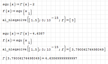

#13 Posted: 6/9/2021 4:23:05 PM
It solves, not with conventional methods.
They tend to give errors, not gamma_r4's fault.
alglib is the answer, it usually gives result.
#14 Posted: 6/9/2021 9:50:11 PM
Good rescue ... OK.
As it looks, sr4 resides at the kernel level.
Thus, it plots but not solve(,,,,)
because not scalar wrt 'x' for the solve bloc.

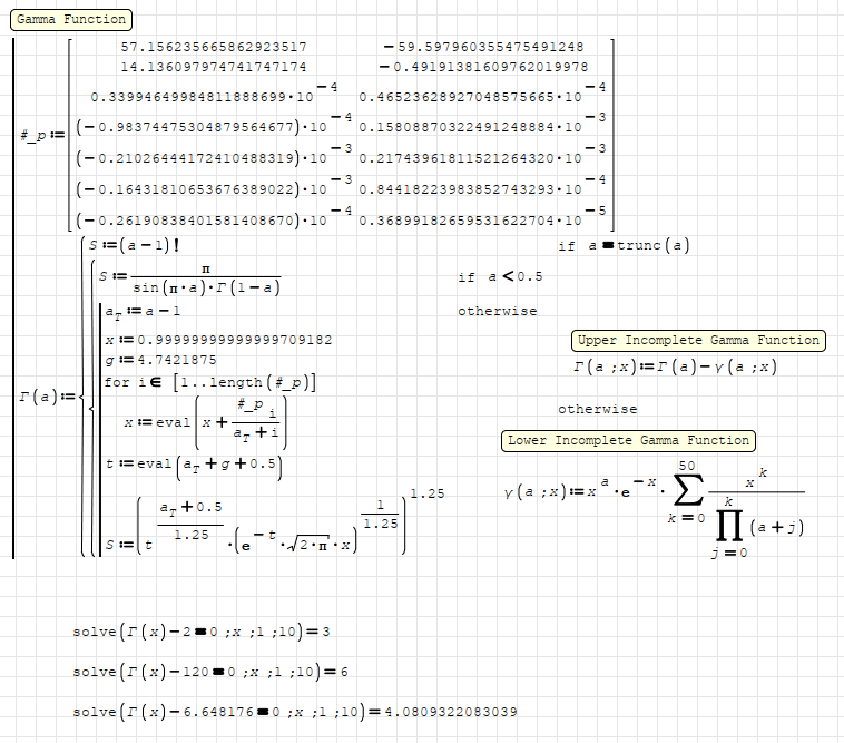

#15 Posted: 6/9/2021 10:06:36 PM
Good rescue ... OK.
Nope, not related with kernel, blocks, scalability, etc.
It is probably a bug of solve(), roots(), FindRoot().
Gamma Function has nothing to do with it.
Even very simple ones suffer from this too.
Check below.
#16 Posted: 6/9/2021 10:22:56 PM
It seems solve(), roots(), FindRoot() doesn't like if statements.
I have updated the bugreport in Bugs and Problems > solve() bug.
Using cases() seems to solve the issue. Check the sample below.

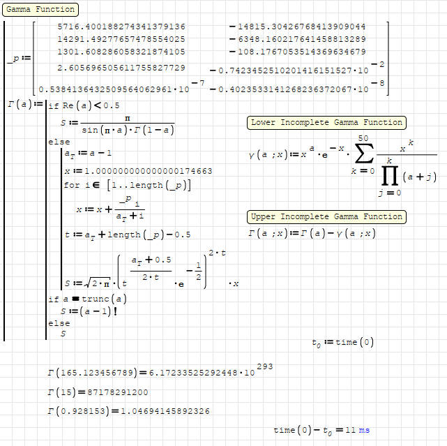

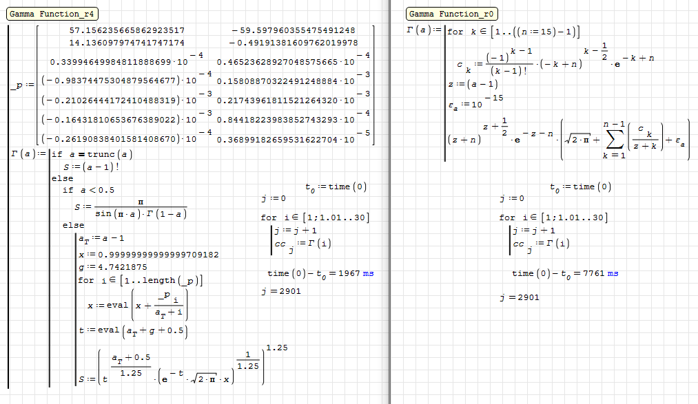

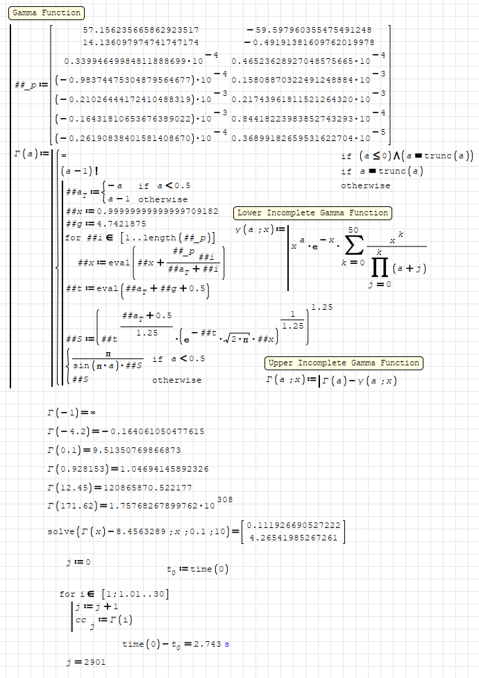

#17 Posted: 6/10/2021 11:16:16 AM
Doctored version confirmed.
#18 Posted: 6/10/2021 10:56:05 PM
gamma_r5 has a serious flaw. It can't calculate a<0.5.
My bad, should check it carefully. Corrected page is below.
Refactored so it is faster, also get rid of recursive call.
I had to get around some smath bugs with line, if/cases, recursive.
Correlation of them gives weird errors.
Hope this version solves all issues and be the last one.
I know I have flooded this topic too much, sorry for inconvenience.
PS: gamma for negative non-integer values support corrected

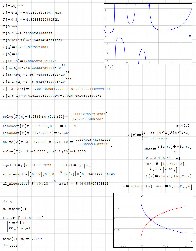

#19 Posted: 6/11/2021 10:16:24 AM
You may not like my verdicts:
1. on-line faster has no or little interest, neither up ^307.
2. Your first version runs fine the two applications.
3. The champion is the long time ago published Alvaro Γ(x)
4. for these two applications [2] & [3] are same
but => [3] drops timing [2] from 24 s down 18 s
The drop in timing results from Alvaro Γ(x)
running at the kernel scalar level.
BTW, my original H.T. Davis sanity Mathcad & Alvaro Γ(x)
By same token, thanks Alvaro for your Γ(x).
Maths Special Gamma(a,x) Incomplete APPLICATIONS [Alvaro G(x)].sm (26.94 KiB) downloaded 1239 time(s).

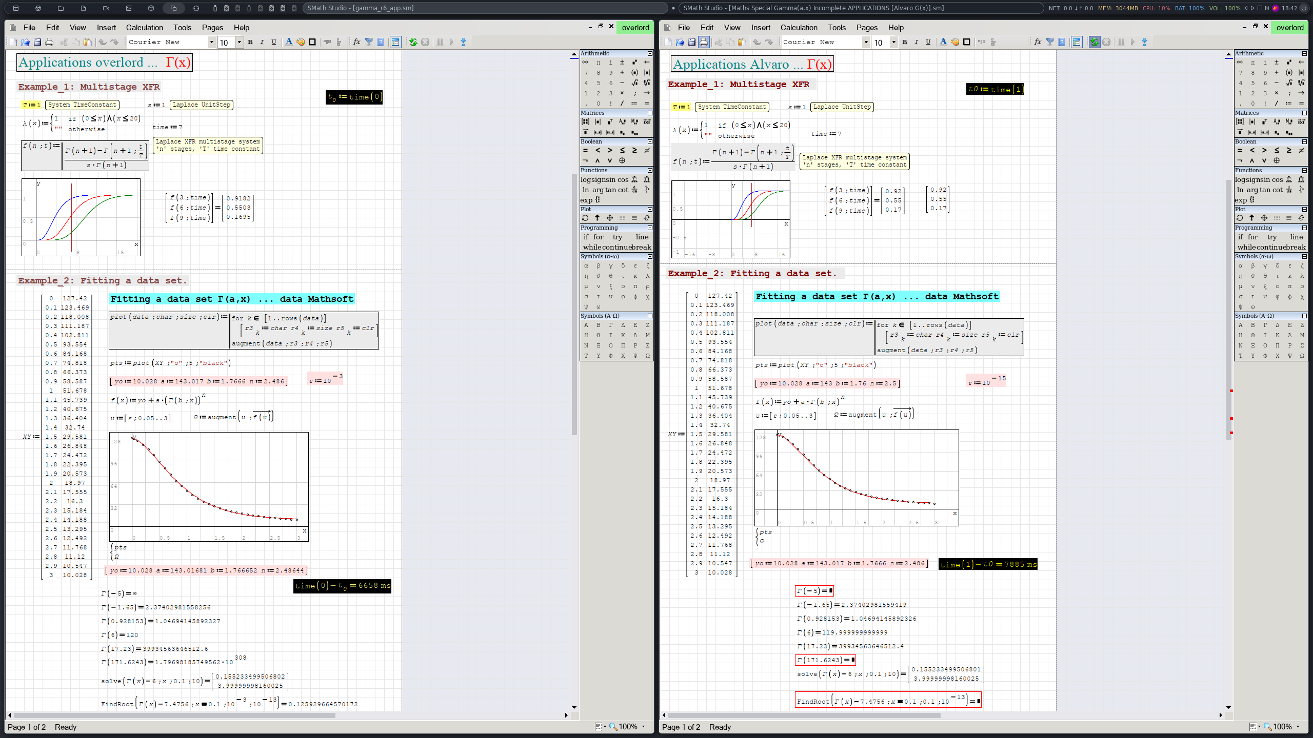

#20 Posted: 6/11/2021 12:45:20 PM

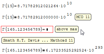

1. 10^308 feature added for fully use IEEE capability.
2. gamma_r6 runs every possible applications.
3. don't want to disrespect, Alvaro's is a single line awesome code.
4. mine has same algorithm with more features, with faster calculation.
4. gamma_r6 is faster from gamma_r2 and gamma_r3 while trying to have all feature.
gamma_r6_app.sm (33.87 KiB) downloaded 1429 time(s).
Here is a side by side comparison with Alvaro's algorithm with mine.
On linux, gamma_r6 is faster about 20 percent.
