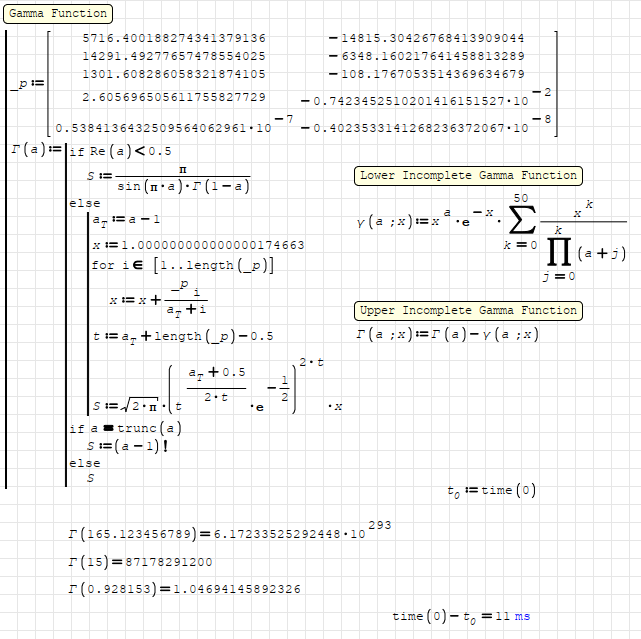

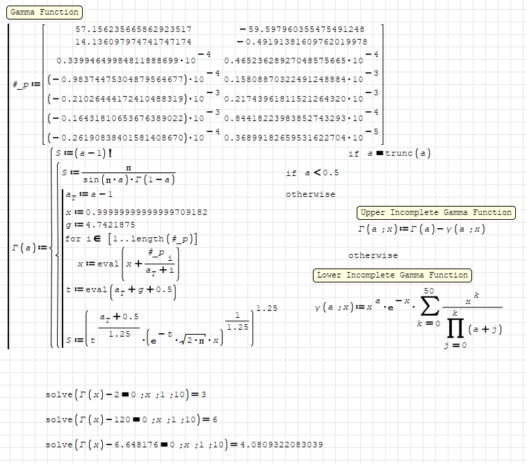

Gamma function,
Lower Incomplete Gamma function,
Upper Incomplete Gamma function,
with almost instant speed and high precision.
gamma.sm (34,69 КиБ) скачан 1443 раз(а). <---- least accurate
gamma_r2.sm (11,52 КиБ) скачан 1434 раз(а).
gamma_r3.sm (11,8 КиБ) скачан 1430 раз(а).
gamma_r4.sm (13,82 КиБ) скачан 1433 раз(а).
gamma_r5.sm (11,38 КиБ) скачан 1476 раз(а).
gamma_r6.sm (17,75 КиБ) скачан 1397 раз(а).
gamma_r7.sm (28,8 КиБ) скачан 1516 раз(а).
gamma_r8.sm (31,51 КиБ) скачан 1539 раз(а).
gamma_r9.sm (36,93 КиБ) скачан 1934 раз(а). <----imaginary numbers added

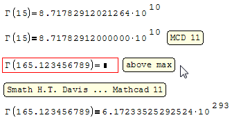

#2 Опубликовано: 08.06.2021 14:57:24
Thanks, will explore.
Main limitation is smath floating points.
Python gives much more accurate results with same algorithms.
Try the other one for gamma calculation.

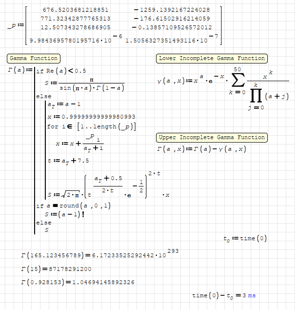

Technically this should be the most accurate one.

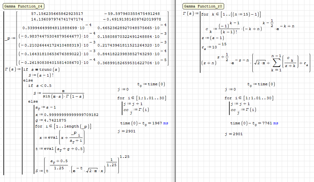

I suggest you to change gamma function with gamma_r4.
It is 3 times faster and much more precise.
#8 Опубликовано: 09.06.2021 13:46:58

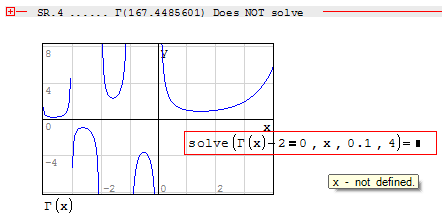

1. NO gain timing both applications
2. gamma_r4 Does NOT solve ... first version solves.
#9 Опубликовано: 09.06.2021 14:06:13
Thanks for gamma_r4
Speed may differ between linux and windows.
gamma_r4 is faster 3 times in linux.
What do you mean by 'does not solve'?
How should this page look like?
gamma(a,x) Applications.pdf (125,35 КиБ) скачан 851 раз(а).
#10 Опубликовано: 09.06.2021 14:19:23
#11 Опубликовано: 09.06.2021 14:36:55
I think this is the same bug I mentioned earlier. Some functions don't like to be in another function.
Solution was to put a line but that method is not working in this case.
@Andrey or @Davide has to look at this.

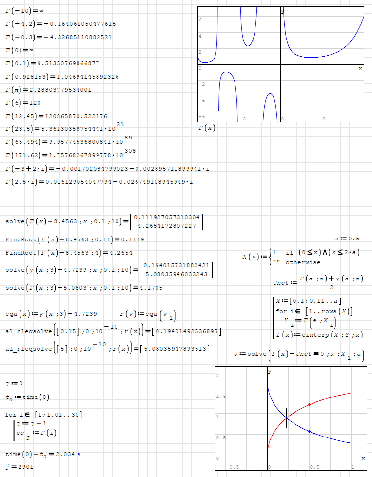

#12 Опубликовано: 09.06.2021 16:03:46
Latest version is faster about 4 times.
#13 Опубликовано: 09.06.2021 16:23:05
It solves, not with conventional methods.
They tend to give errors, not gamma_r4's fault.

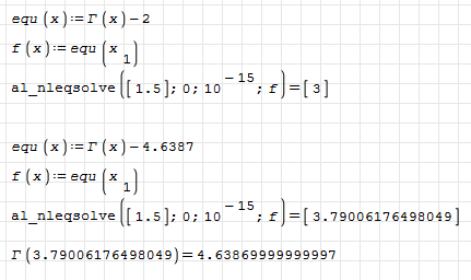

alglib is the answer, it usually gives result.
#14 Опубликовано: 09.06.2021 21:50:11
Good rescue ... OK.
As it looks, sr4 resides at the kernel level.
Thus, it plots but not solve(,,,,)
because not scalar wrt 'x' for the solve bloc.
#15 Опубликовано: 09.06.2021 22:06:36
Good rescue ... OK.
Nope, not related with kernel, blocks, scalability, etc.
It is probably a bug of solve(), roots(), FindRoot().
Gamma Function has nothing to do with it.
Even very simple ones suffer from this too.
Check below.
#16 Опубликовано: 09.06.2021 22:22:56
It seems solve(), roots(), FindRoot() doesn't like if statements.
I have updated the bugreport in Bugs and Problems > solve() bug.
Using cases() seems to solve the issue. Check the sample below.

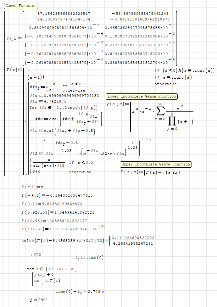

#17 Опубликовано: 10.06.2021 11:16:16
Doctored version confirmed.
#18 Опубликовано: 10.06.2021 22:56:05

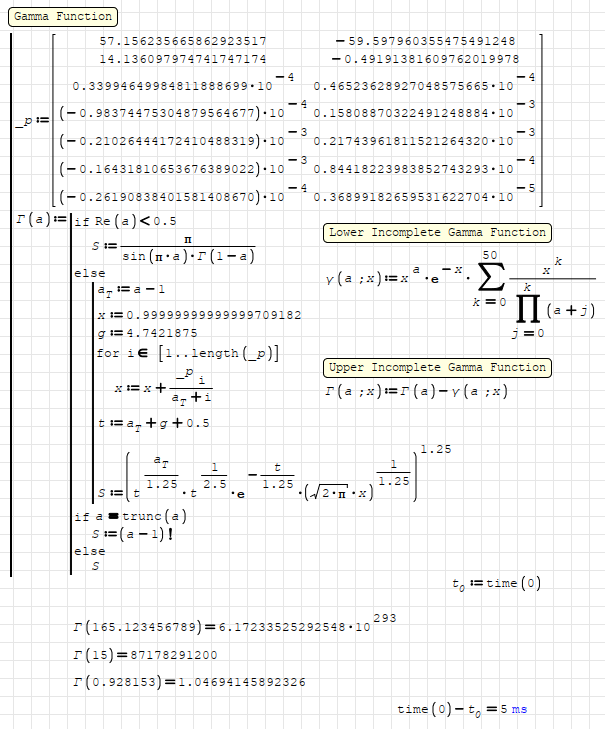

gamma_r5 has a serious flaw. It can't calculate a<0.5.
My bad, should check it carefully. Corrected page is below.
Refactored so it is faster, also get rid of recursive call.
I had to get around some smath bugs with line, if/cases, recursive.
Correlation of them gives weird errors.
Hope this version solves all issues and be the last one.
I know I have flooded this topic too much, sorry for inconvenience.
PS: gamma for negative non-integer values support corrected

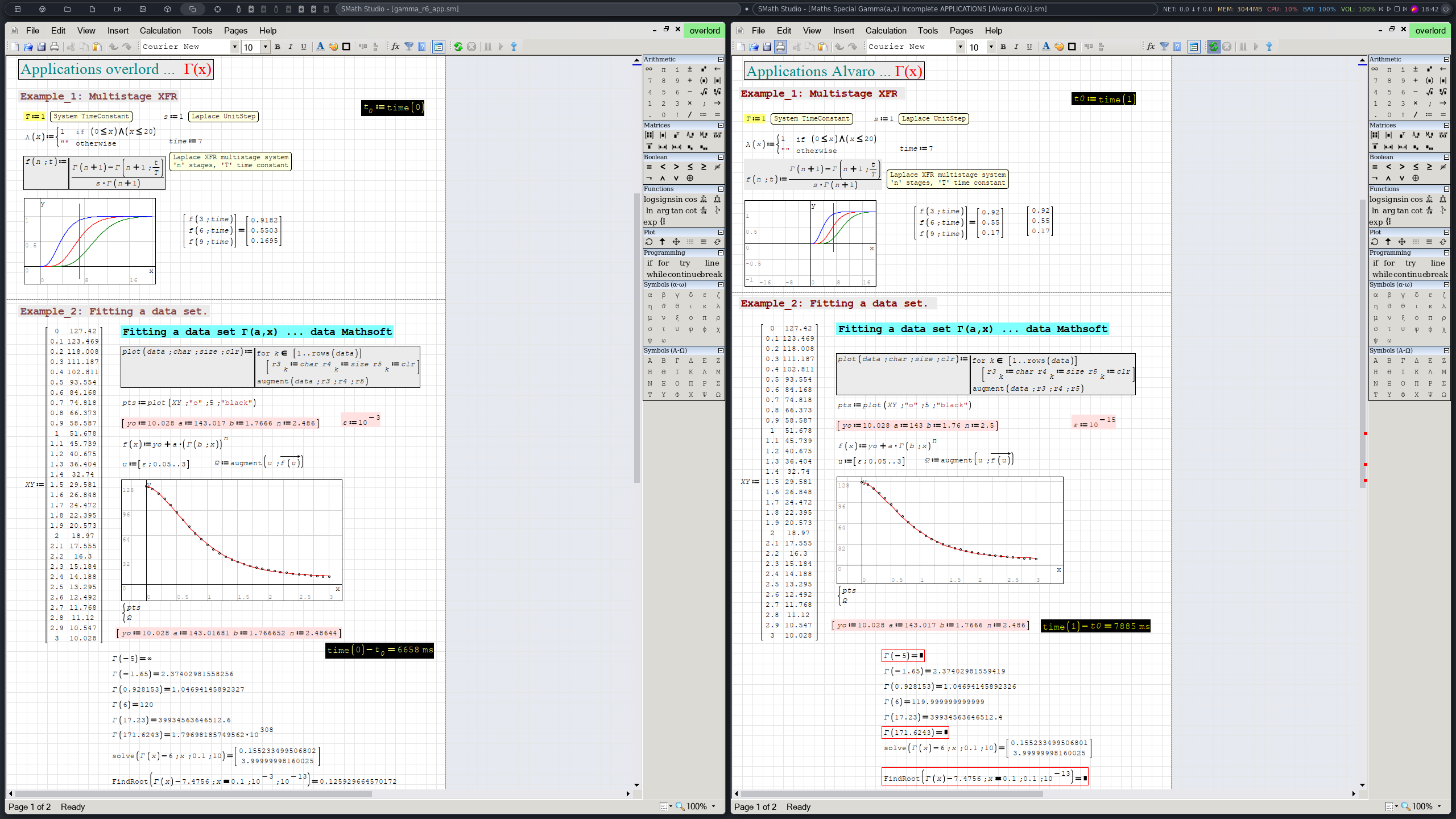

You may not like my verdicts:
1. on-line faster has no or little interest, neither up ^307.
2. Your first version runs fine the two applications.
3. The champion is the long time ago published Alvaro Γ(x)
4. for these two applications [2] & [3] are same
but => [3] drops timing [2] from 24 s down 18 s
The drop in timing results from Alvaro Γ(x)
running at the kernel scalar level.
BTW, my original H.T. Davis sanity Mathcad & Alvaro Γ(x)
By same token, thanks Alvaro for your Γ(x).
Maths Special Gamma(a,x) Incomplete APPLICATIONS [Alvaro G(x)].sm (26,94 КиБ) скачан 1239 раз(а).

1. 10^308 feature added for fully use IEEE capability.
2. gamma_r6 runs every possible applications.
3. don't want to disrespect, Alvaro's is a single line awesome code.
4. mine has same algorithm with more features, with faster calculation.
4. gamma_r6 is faster from gamma_r2 and gamma_r3 while trying to have all feature.
gamma_r6_app.sm (33,87 КиБ) скачан 1429 раз(а).
Here is a side by side comparison with Alvaro's algorithm with mine.
On linux, gamma_r6 is faster about 20 percent.
