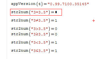

I need to evaluate a condition (Boolean) that I have to build on a case-by-case basis. In testing this situation, I experienced the incorrect behavior of the "str2num" function in the case of the "=" sign.

Clearly a bug it does not recognize 'Numeric'

Try this.

thank you uni, it's a good buffer solution; only a minimum discomfort remains for entering the correct character.
