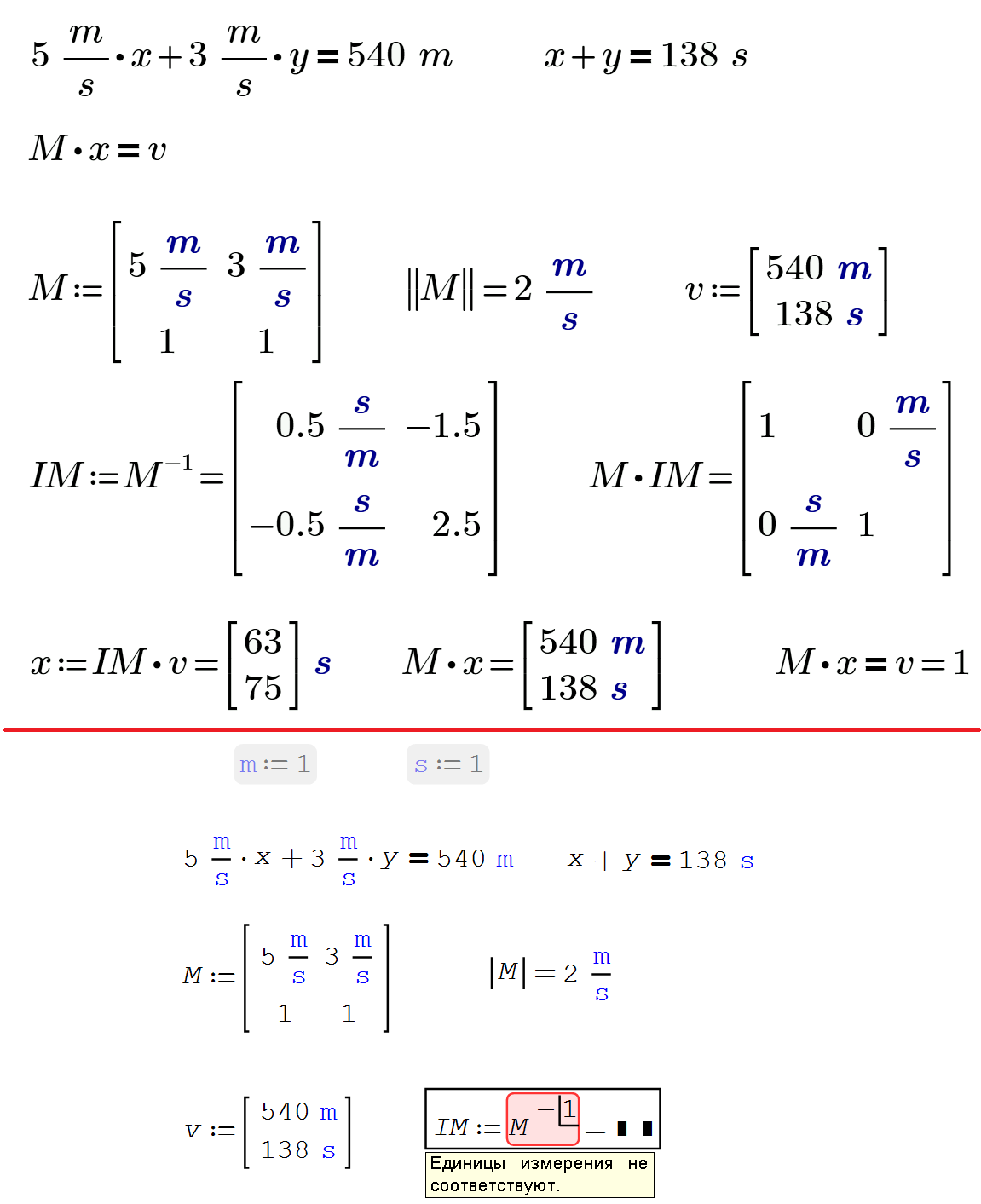

Mathcad vs SMath

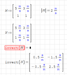

There is invert() function for that but it won't work with mixed units.

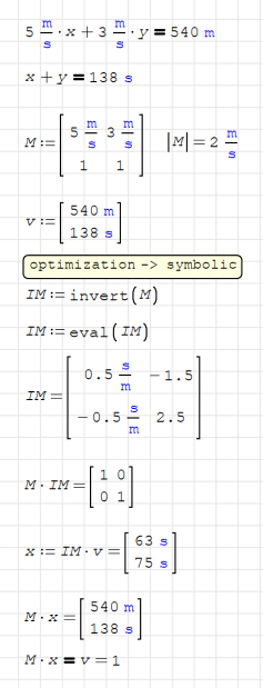

Nevermind, I found a way for invert.
Here is your solution.
invert.sm (9.09 KiB) downloaded 1795 time(s).

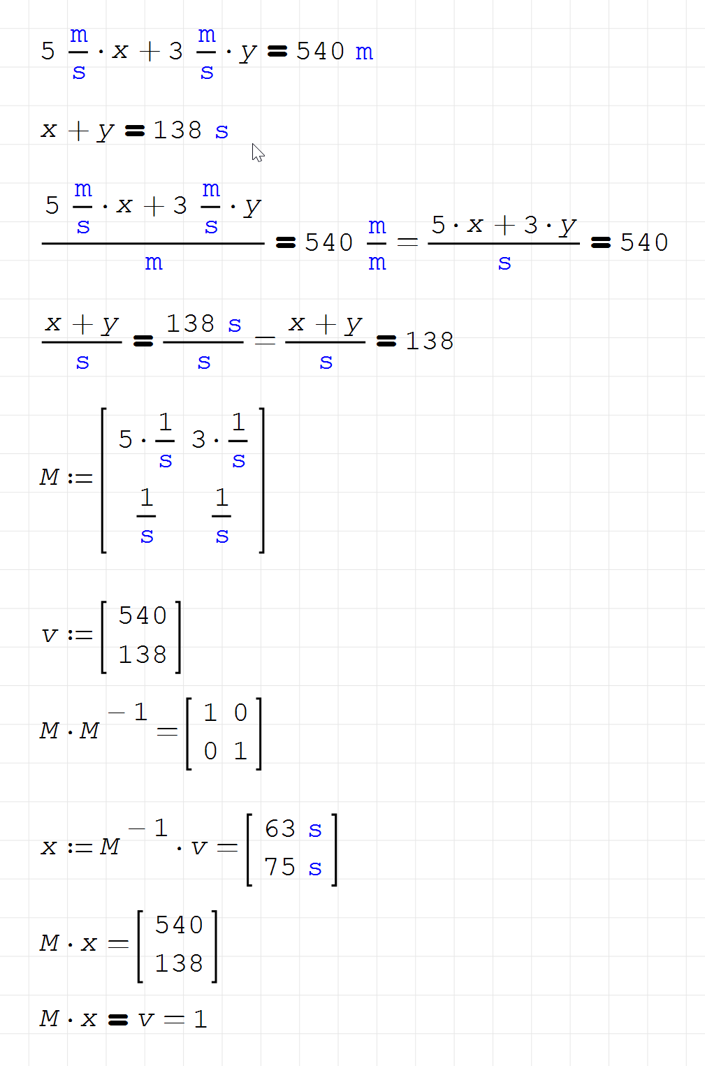

I take inspiration from Overlord
