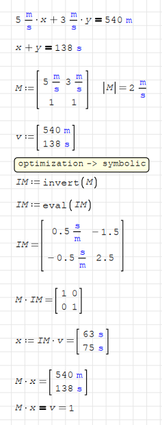

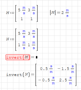

There is invert() function for that but it won't work with mixed units.
#3 Опубликовано: 21.05.2024 17:10:58
Nevermind, I found a way for invert.
Here is your solution.
invert.sm (9,09 КиБ) скачан 1795 раз(а).

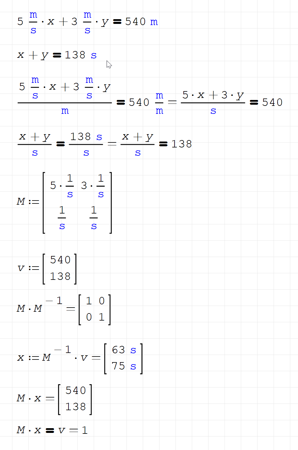

#4 Опубликовано: 21.05.2024 18:19:03
I take inspiration from Overlord
