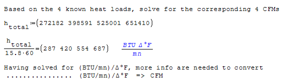

#2 Posted: 4/13/2016 7:10:44 PM
Before applying some suite, you must have something to process.
With only two temp. BTU means nothing. Two values are missing.
With the two you provide: who knows to what BTU rate they apply ?

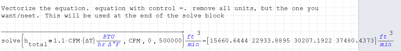

Maybe like this ?

I'm not sure why would you need the solve() when you may directly calculate the result as you did,
but here it goes Solve Block.sm (7.95 KiB) downloaded 1188 time(s).
solve() cannot find units, so you need to "help" it allowing it to search for unitless values and adding required units by hands. Also, it cannot search matrices - so iterate it (I used vectorize() ).
Third - you need to pay attention when you use assignments, and when - comparisons. You happened to use := in solve() instead of ≡.
Fourth - solve(#,#) searches inside the range that is set in program's settings - use solve(#,#,#,#) to define custom range

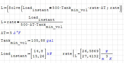

#13 Posted: 8/3/2017 4:19:33 PM
1,361 likes in 2,275 posts.
Solve() from the Maxima plugin
solve%20block%202.sm (4.91 KiB) downloaded 1237 time(s).

mkraska - Thank you, but not what I was looking for. I have the power already calculated/known ... I am looking to solve for a rate of time. As you can see in my example, the program will solve as long as I do NOT define the solve block with a variable. It also looks like you are using the Maple plugin.
Update, I thought that Vectorize eliminated the nesting issue. I think that is what is going on as my solution may be a nested item and not a matrix. Definitely a nesting issue. How do I "un-nest" a Vectorized equation? Solve Block 2.smz (2.87 KiB) downloaded 1209 time(s).without jMG Matrix manipulation. I was hoping Vectorize would simplify the issue.

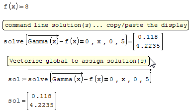

#15 Posted: 8/4/2017 10:55:57 AM
The solve block is not compatible for assigning objects that are vectorized.
This was first noticed solving Gamma(x), that solves un-assigned.
erf(x), Gamma(x) are two reported, that solve from vectorising, not assignable.
Nothing to do => copy/pate ... Does not spool to file either
ElSid 8/4/2017 2:50:00 PM

#18 Posted: 8/4/2017 9:29:59 PM
Any recommendations?For now, I will do copy and paste, but I would like to "automate" the solution since these numbers are used downstream.I'm not seeing a programmed solve program, unless there is an example I missed in the forum.
You have missed nothing from the forum, has never bee exemplified.
I don't work with units, sorry for your work sheet.
As explained before => Gamma(x) is one that needs be vectorised locally
That does not exclude global vectorising for further use, downstream the document.
Cheers Esild ... Jean
