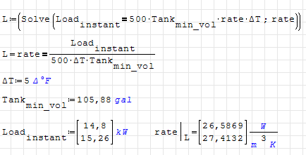

Doing something wrong ...
Trying to solve empirical formula with matrix input using either solve or maple(solve)Solve Block.sm (12,98 КиБ) скачан 1210 раз(а).

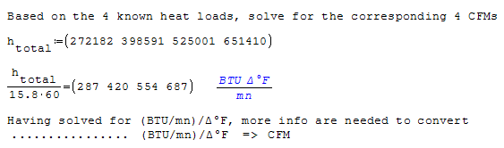

Before applying some suite, you must have something to process.
With only two temp. BTU means nothing. Two values are missing.
With the two you provide: who knows to what BTU rate they apply ?

I do. Based on empirical formula, I want to solve for the "flow" based on the total energy. Delta T is constant, so I don't understand your comment.
Here is a revised file, hopefully clearer as to what I am looking for...
Solve Block.sm (7,19 КиБ) скачан 1267 раз(а).

Maybe like this ?

The first descriptor shows ME doing the algebraic manipulation and getting the correct answer. I am trying to use "solve" to solve the equation with no success. As always, thank you for looking and responding

I'm not sure why would you need the solve() when you may directly calculate the result as you did,
but here it goes Solve Block.sm (7,95 КиБ) скачан 1216 раз(а).
solve() cannot find units, so you need to "help" it allowing it to search for unitless values and adding required units by hands. Also, it cannot search matrices - so iterate it (I used vectorize() ).
Third - you need to pay attention when you use assignments, and when - comparisons. You happened to use := in solve() instead of ≡.
Fourth - solve(#,#) searches inside the range that is set in program's settings - use solve(#,#,#,#) to define custom range

I like documenting and showing the empirical equations for others to "see", whenever possible. Yes, easy for me to re-arrange, put I wanted to keep the look of the empirical equations when possible. This is one for Jean and his units argument.
Why do we need to put the range? (solve(4)) I thought Solve two went only on the positive side so range was not needed. I guess I should de-fault to more instead of less. I had something similar without the units corrected as you did it...at one point

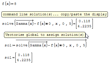

The solve block is not compatible for assigning objects that are vectorized.
This was first noticed solving Gamma(x), that solves un-assigned.
erf(x), Gamma(x) are two reported, that solve from vectorising, not assignable.
Nothing to do => copy/pate ... Does not spool to file either

As explained before => Gamma(x) is one that needs be vectorised locally
That does not exclude global vectorising for further use, downstream the document.

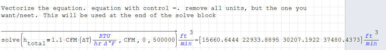

That' the best I can do.
1. Subscript should not exist [complicate matters].
2. What are "Units" doing in Engineering works ?
solve block 2 Examine Solutions.sm (7,26 КиБ) скачан 1165 раз(а).

Finally, an example that shows WHY we need units the items in the array are in kW and need to be in BTU/hr for the empiracle equation to be valid. If I split the array like you did, it does what i need ... wondering why I cannot do it with vectorize Solve Block 2a.smz (4,41 КиБ) скачан 1258 раз(а).
