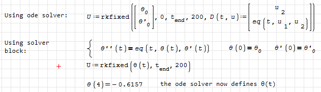

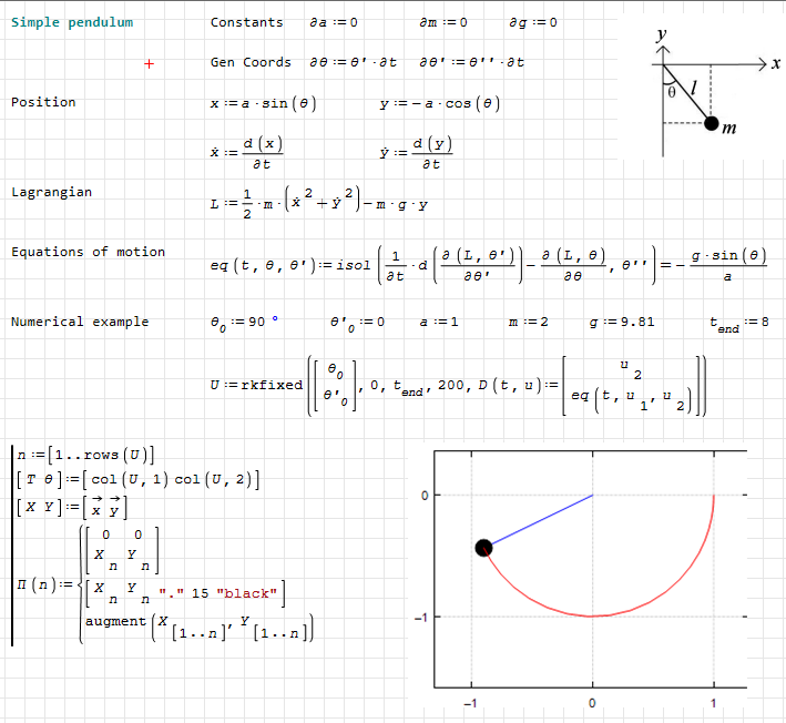

SMath Forum SMath Studio Samples Double pendulum model and animation 2 Pages (22 items) Previous 1 2 Double pendulum model and animation - Is the model correct? - Messages Go to last post #21 Posted: 11/6/2025 3:38:47 PM Alvaro 1,139 likes in 1,805 posts. Group: User Hi. Here it is.SimplePendulumLagrangian.sm (87.38 KiB) downloaded 1086 time(s).Best regards.Alvaro. #22 Posted: 11/6/2025 10:41:17 PM Alvaro 1,139 likes in 1,805 posts. Group: User Hi. I added the method of using the solver block for the simple pendulum problem. It's always good to have more than one method for solving things.SimplePendulumLagrangian.sm (90.39 KiB) downloaded 1083 time(s).Best regards.Alvaro. 2 Pages (22 items) Previous 1 2 New Posts No New Posts
