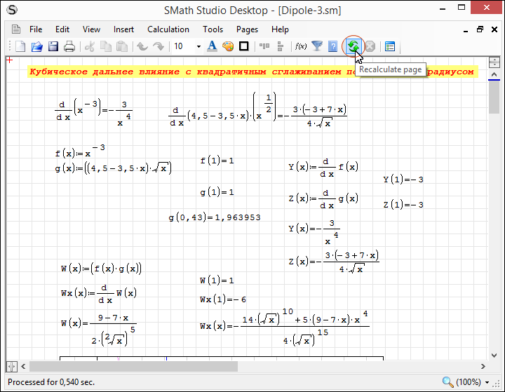

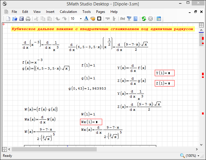

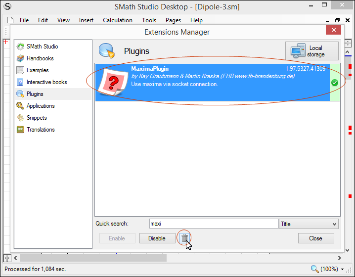

Как уже выше написали, проблема в плагине Maxima - просто удалите его и ваш расчёт снова заработает.
(ENG: As already mentioned above issue is in the Maxima plug-in - just remove it to restore your worksheet.)

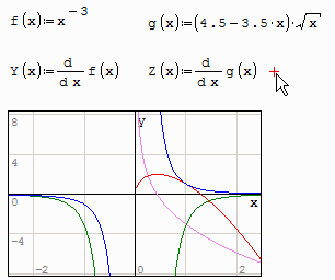

You show the plotting arguments Y(x), Z(x) but not plotted.
Is it because they don't plot at home ? Just puzzling.
#23 Posted: 4/8/2016 3:17:27 PM
... Ah ! the plot forum was deleted.

Ни один русский , это не перевод Google .
Зонд ваш файл Диполь -3.sm и Maxima плагин включен , отключить плагин , я закрыл файл , и я открыл ее , и она прекрасно работает
No Russian, this is a translation of Google .
Probe your file Dipole -3.sm and Maxima plugin is enabled , disable the plugin, I closed the file, and I opened it , and it works perfectly

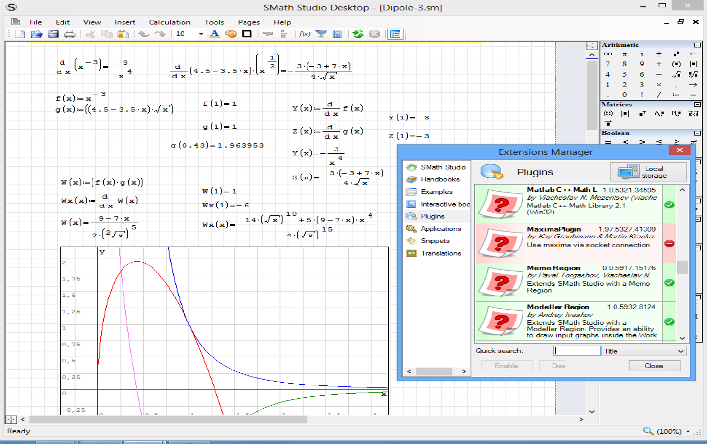

#25 Posted: 4/9/2016 1:37:21 AM
I just had the plot from native 5346, nohing to game with.
What's that story to kill JoBlo to get Art whisle .
Starting at least with RC1 of 0.98 (didn't check earlier versions so far) there is a problem with the Maxima plugin breaking the built-in diff function.
I filed a bug report BTS 2311
Seems that the api changes require rework of the plugin. Unfortunately, this won't happpen soon, as it requires me to learn C# and to dig into the code. Feel free to add examples to the bug report. One day this might help with fixing the bug.
A workaround is to take over the diff function by maxima using MaximaTakeover("all" ), but I also had to add a line operator to the function definition in the example in the bug report.
