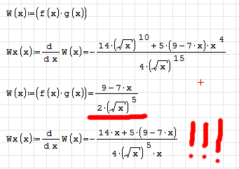

Пожалуйста поправьте ошибку, появившуюся после версии 097-5890
ЧЯДНТ?
Actually, I see another strange thing, that nevertheless, doesn't change results: If I show result immediately on assignment, following derivative optimizes differently.
С уважением, Михаил Каганский

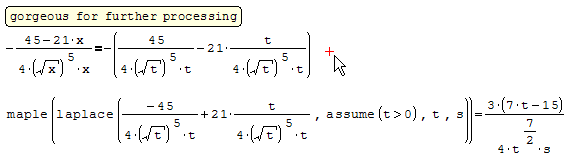

#4 Posted: 4/5/2016 12:23:32 PM

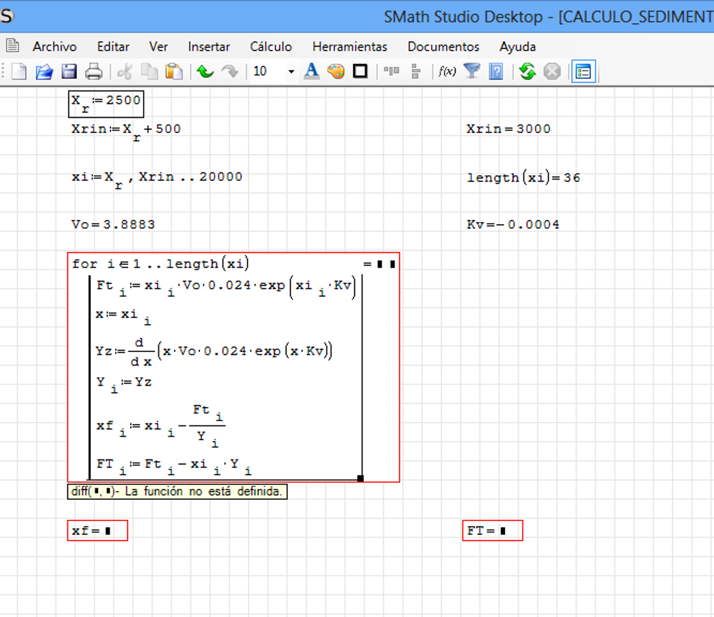

In the new version of Smath Studio ( 0.98 5935 ) , the "diff" function does not work properly, and gives the following error : diff () function is not defined.
Could you guys please check if a plugin causes that? Does disabling plugins solve the problem?

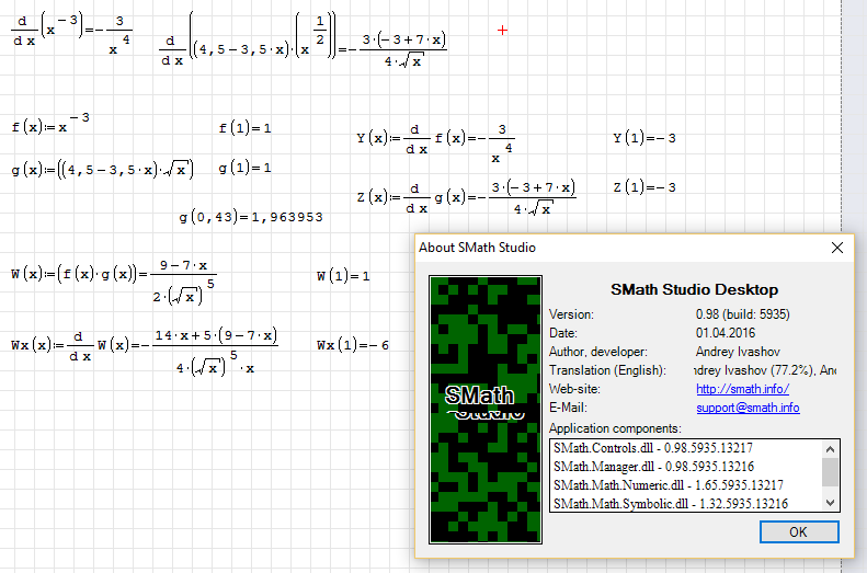

#10 Posted: 4/6/2016 2:16:34 AM
This worked very well with the previous version of
Smath Studio with the same plugins that I have installed.
Try other style 'diff'
Forum Legendre Test.sm (8.66 KiB) downloaded 1400 time(s).

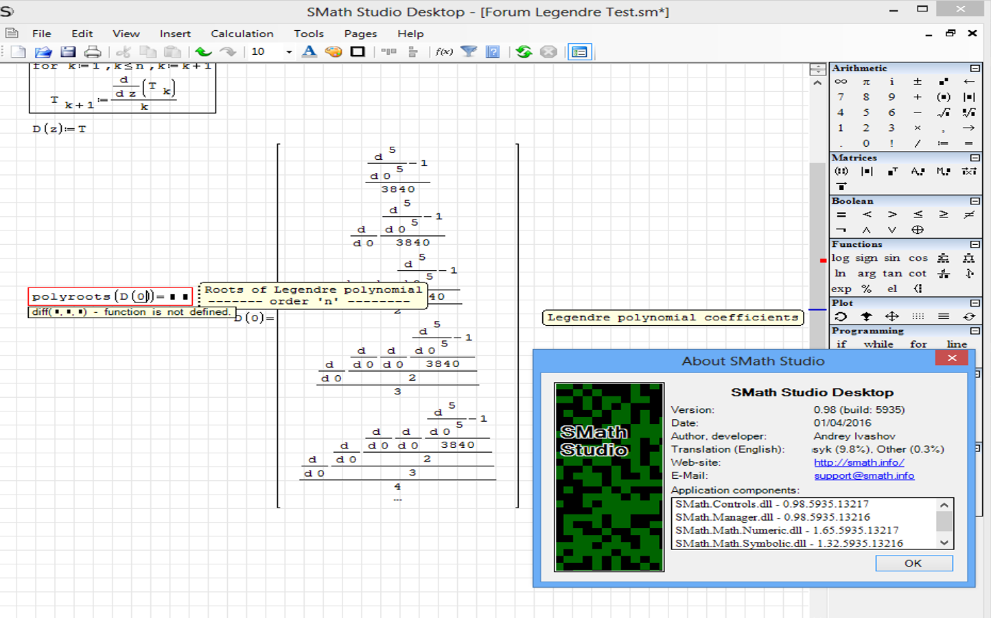

Jeand Giraud:
Your "Forum Legendre Test.sm", file does not work correctly in the current version of SMath Studio that I have installed.

mikekaganki : I disable all plugins, and the problem persists .
It seems to be a bug in the new version

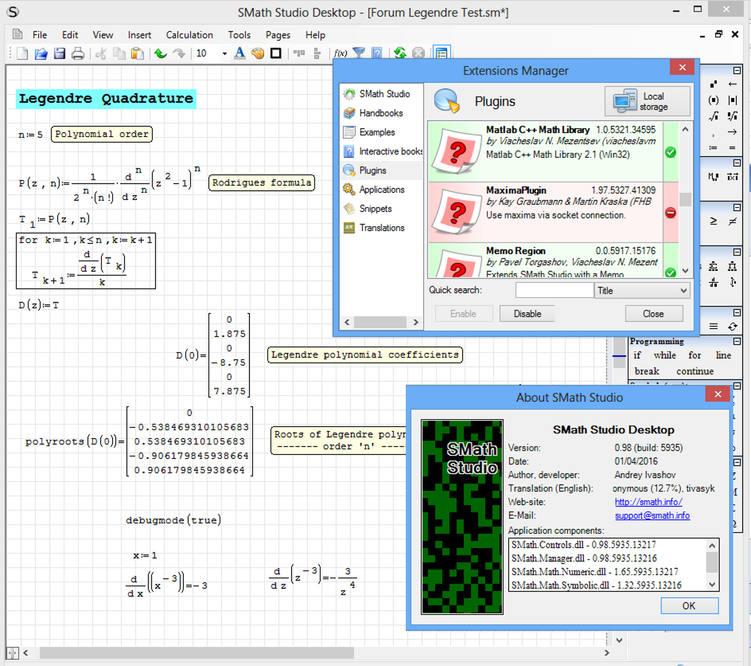

#14 Posted: 4/6/2016 1:03:46 PM

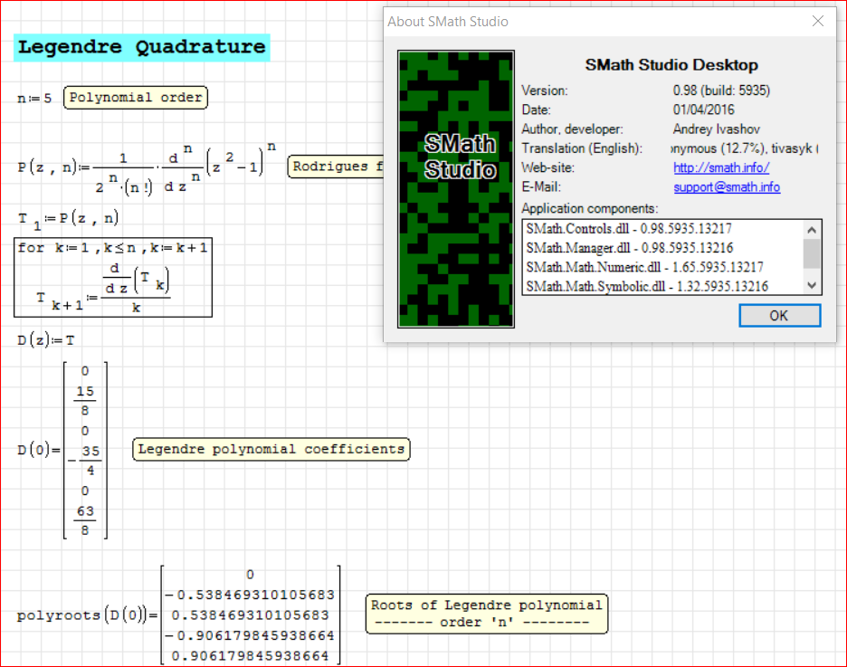

NDTM Amarasekera
NDTM Amarasekera
130 likes in 352 posts.
It works for me in SS 98.5935.

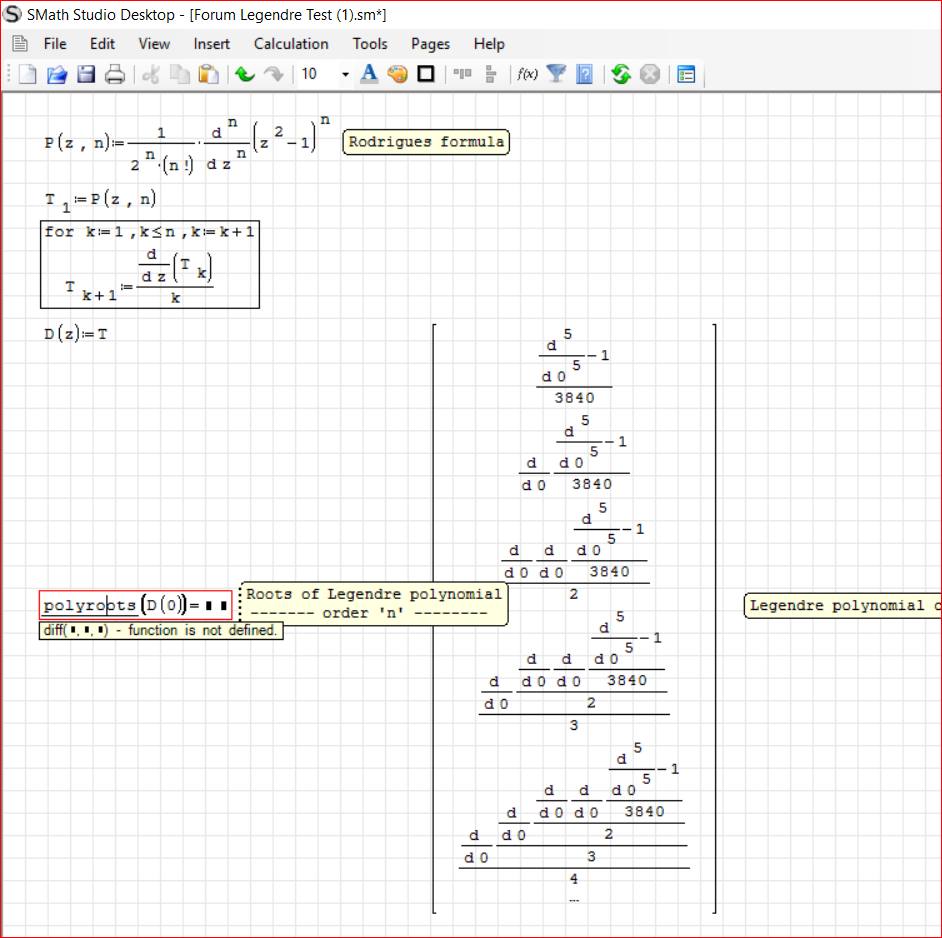

#15 Posted: 4/6/2016 1:04:08 PM
Thanks "CBG" for reporting. In Smath 5346 it does not go further than order 5,

#18 Posted: 4/6/2016 1:51:27 PM
NDTM Amarasekera
NDTM Amarasekera
Hi Jean,
Thanks.
The culprit is the Maxima plugin. We have to delete this plug in to get your program to run correctly.
If the plugin is disabled and then re-calculated, the program will run correct.
However, disabling is not effective, as the error will re-appear when the program is reloaded.
The error is reproduced below.
3 users liked this post
Andrey Ivashov 4/6/2016 2:16:00 PM, Fridel Selitsky 4/6/2016 2:19:00 PM, sergio 4/6/2016 4:07:00 PM
#19 Posted: 4/6/2016 2:12:25 PM
CBG
CBG
78 likes in 312 posts.
I found the fault, this is caused by the Maxima Plugin.
I Disable it , and Smath Studio works perfectly .
Mikekaganki was right .
Thanks and regards
to all
CBG
